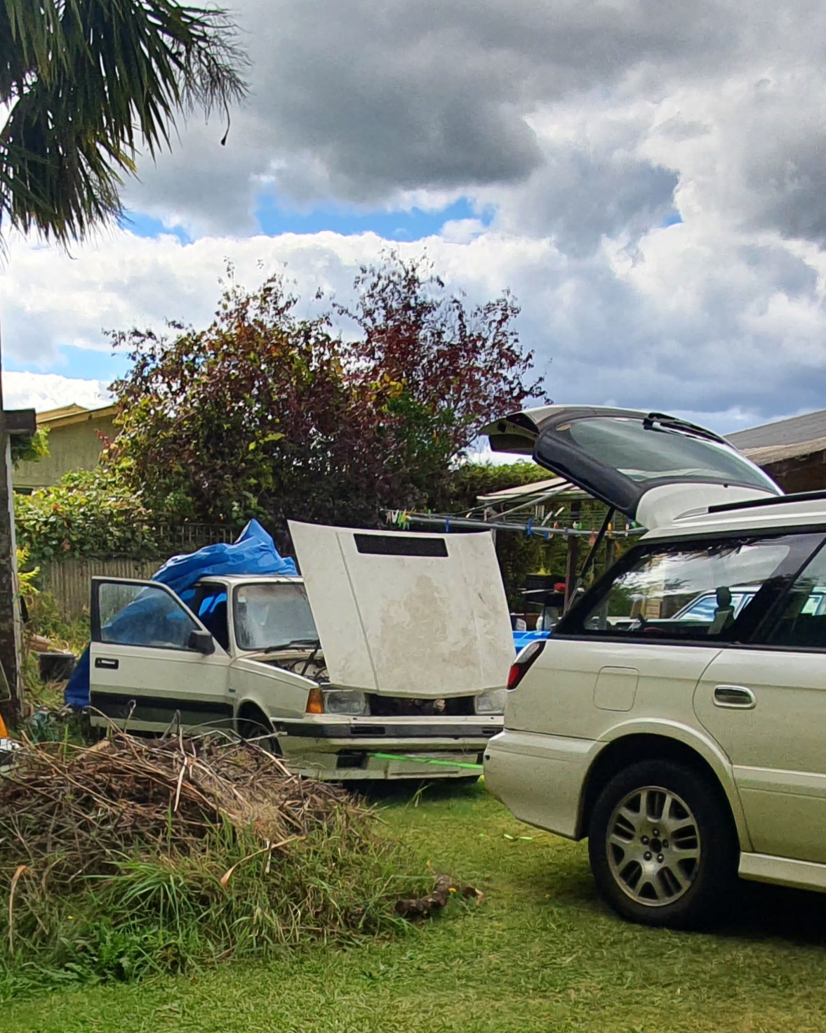

A friend made an aquisition a couple of weeks ago which has given me a bit of a kick up the ass to get on a bit with my old girl. So i dragged her out to check all of the engine bay wiring after i swapped looms as i now had something to compare to.
So i did this thing where i connected the battery and made me an ignition spider (cbf finding the key).
Now, i got a mixed bag;
Attempt one: connected the starter wire, and she cranked two or three times (i knew it spun free beforehand). I tried to crank it again and got nothing. Not even a click from the solanoid. *didn't try crank it here on out
Attempt two: connected the power wires. Got the "seat belt warning" light on the dash, and the hazard triangle on solid, unless i turned the lights on, at which point it went away.
Attempt three: swapped the cluster plugs around. Had solid power on the rear fog light lamp , pressing the hazard switch made the rear window defroster light and one side indicator flash.
Attempt four: closed the door and went inside.
Seems like i have some wiring gremlins to track down 🤔
Also tee'd up an ex-panelbeater mate to come around and have a gander at the rust in the next few weeks.
