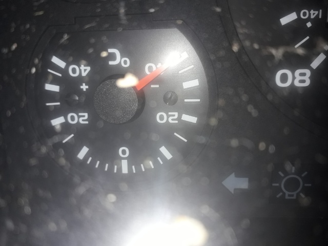

Is this it ??
Sorry left me mince pies downstairs. Its upside down isn't it.
I can't remember what I promised to look for, sorry. This doesn't look like the oil temperature thing you mentioned in another thread.

Ah, thats an ambient temp gauge, looks like a 6 dial dash with an econometer gauge in the other corner assuming it is complete.
Would be quite interested if its going spare and you might consider selling it, they work off a small plug in sensor usually located behind the bumper to pick up the air temperature.
Ideally I am after an oil temperature gauge for my centre console, any gauges like the pic (not mine) would be of interest.
Thanks for taking the time to look...! :)
