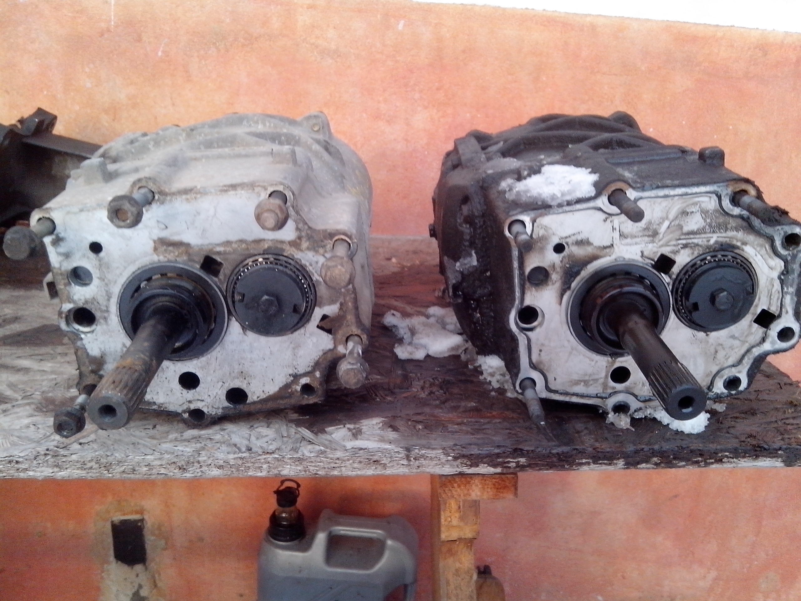

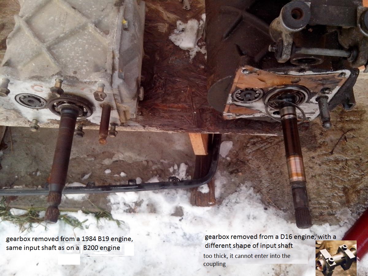

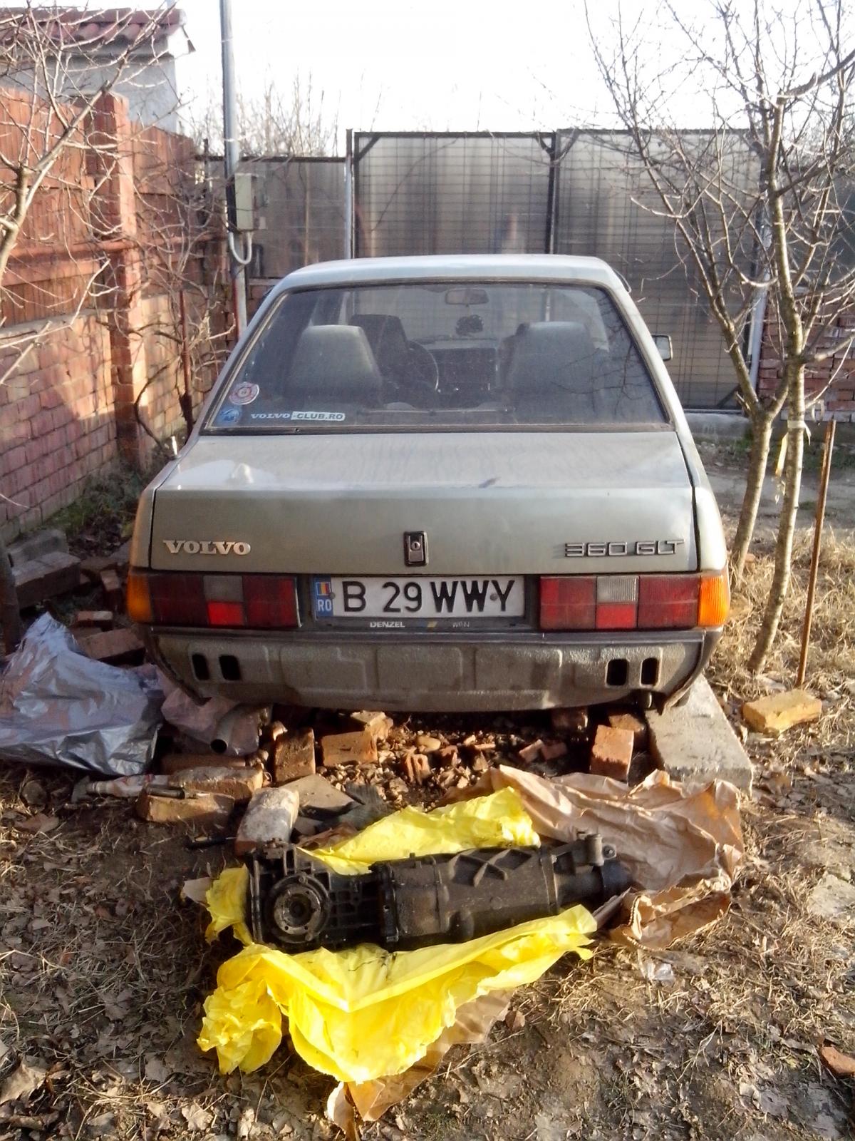

Well, the input shaft on the D16 box has a different shape/ grooves on it. The box that was on the car is #%#$ as you can see, but i have another box, from my first b19 1984. The last one is also knackered, before it went out there were some strange grinding noises coming from it, and one day spoof! Changed from 2nd to 3 rd and that was all, there was no power towards the diff. Now, these days i`m planning to go to a workshop to solve this problem, but i have a couple of questions.
1. On the big bearing / input shaft is marked SWEDEN 6306-EZNTN9HE1/C4. Do you know another compatible bearing code?
2. Regarding D16 box- on Haynes manual i can`t find the gear ratios. I know that a gear box has different ratios depending of the engine-petrol or diesel.
What is my best option? Shall i try to make a good box out of the two petrol ones, or should i try to swap the input shaft on the D16 box?

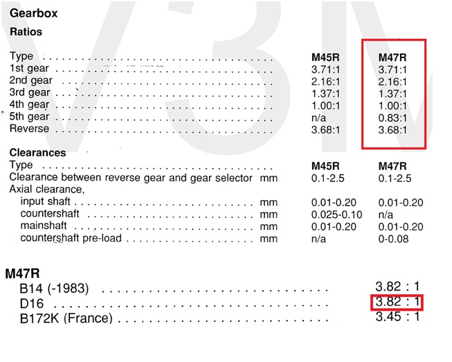

Thanks Mac, but that pdf is on my shelf printed, on my phone and even on my pc at work (on my docs, and now even on D partition, just in case).
I have read it once again, and it says that only the diff ratios are different between b200 and d16. Is it doable to put one of the input shaft from a petrol box on the d16 box and that`s all?

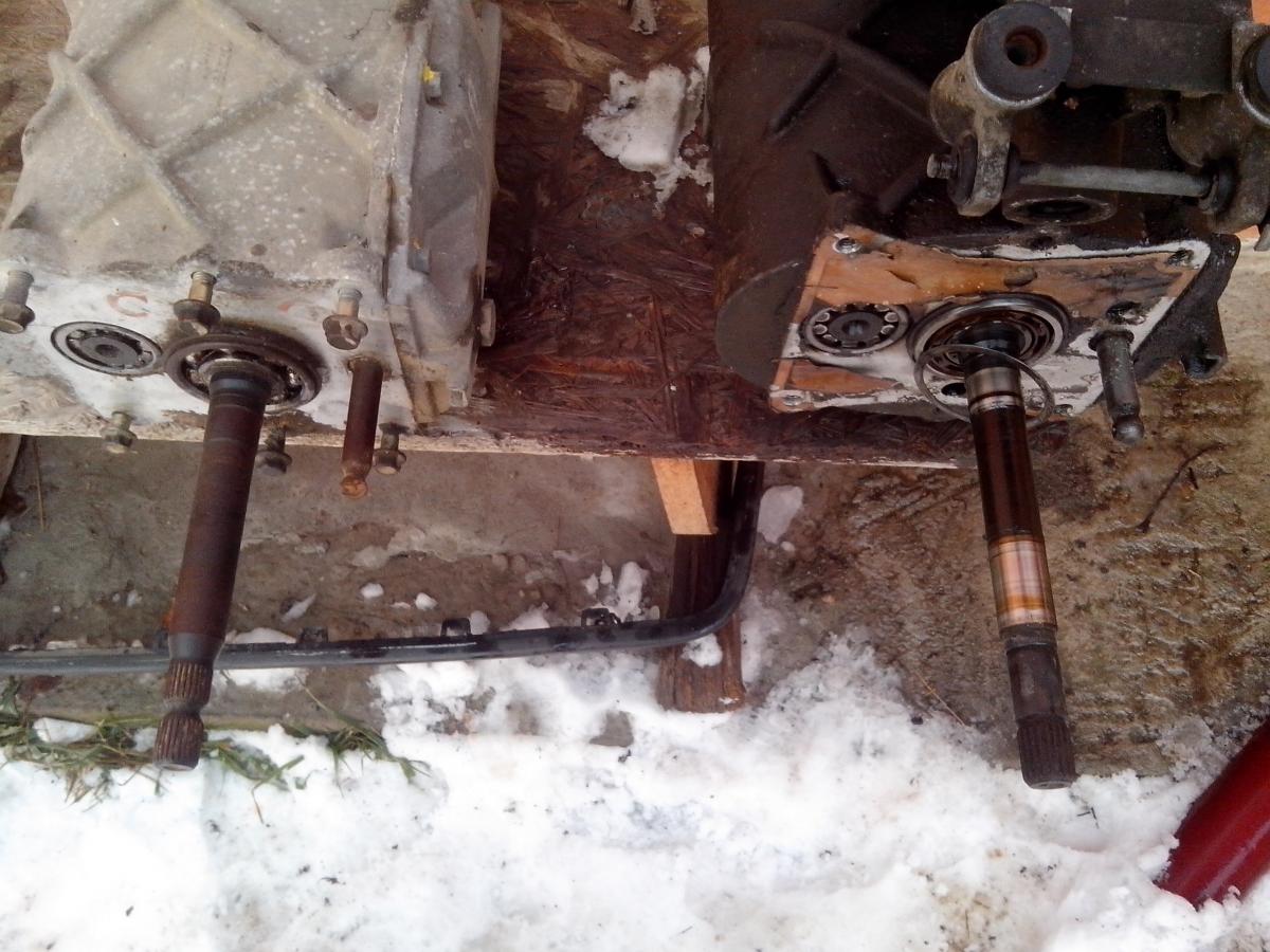

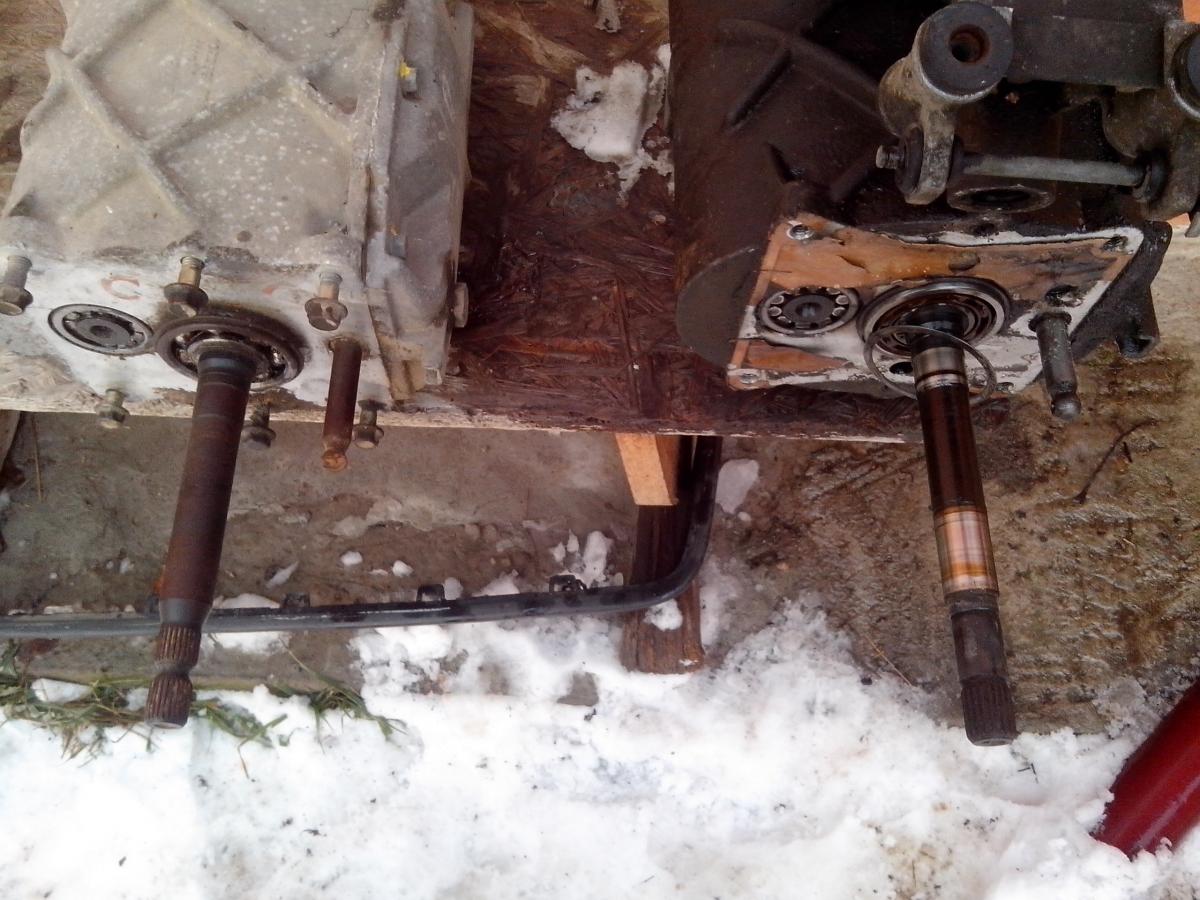

. My biggest concern is that the box which i have pulled out of the car- in pics is the one with knackered input bearings is beyond repair (syncros, gear wheels). On the other hand, my first box from a B19 engine is also non-woking, which leaves me with the D16. Well, i do not know how to express myself for the best: on a B200E engine, if i put a D16 box this would result in "short" gear ratios? I mean i don`t know if i should say to the mecanic let`s do that, dismantle the b19 box, take its input shaft and throw it inside the D16.

The diff ratio won't make much difference. But I am confused, are you changing the gearbox, diff or both? The gearbox ratios are fixed and the same between models, the diff ratio varies between models.

That`s all i wanted to hear, that the gearbox ratios are identical, no matter there were mounted on a gas engine, or a diesel engine. i`ll keep you up-date tomorrow: so i`ll have to swap the input shafts between the boxes in the picture below (the one in left is non-working), and i`m going to keep the original diff of my car.Ride_on wrote: The gearbox ratios are fixed and the same between models, the diff ratio varies between models.

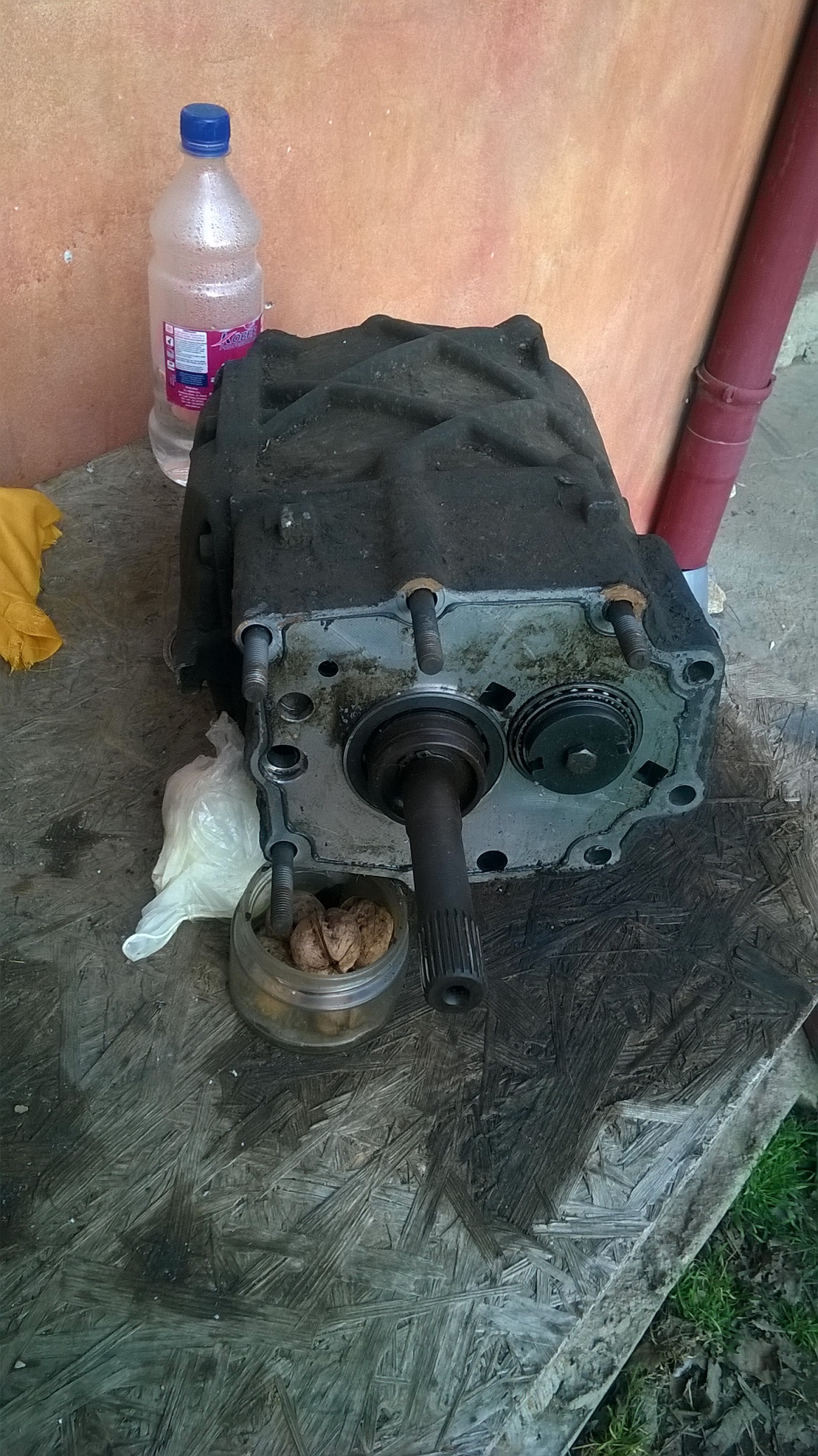

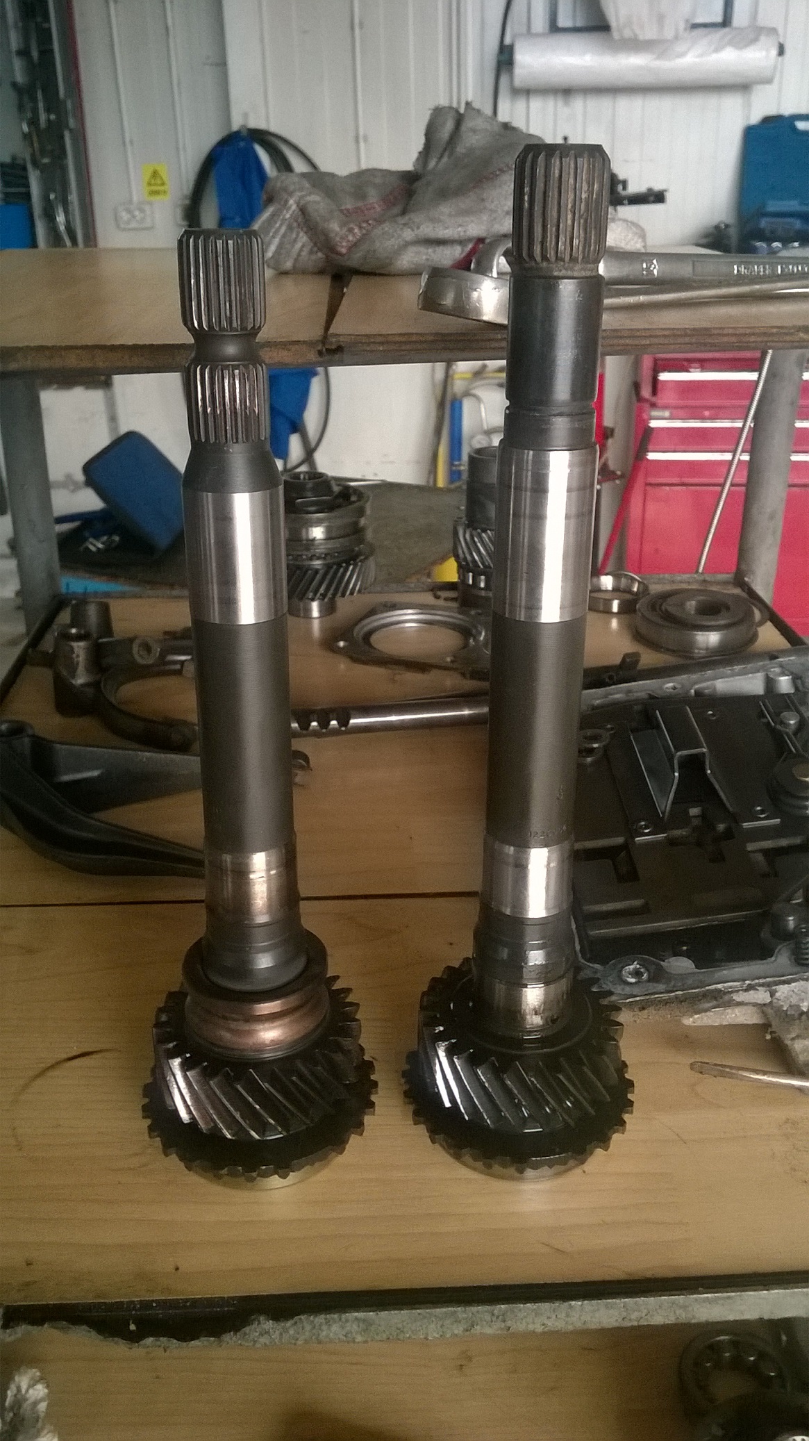

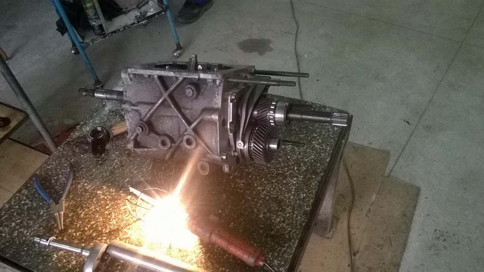

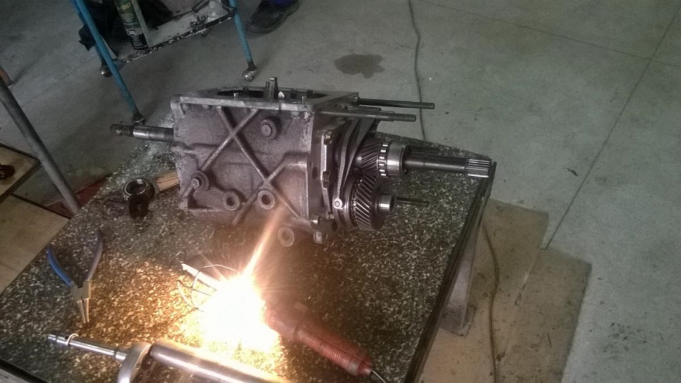

Ride-on, you were right!
So, dear all, i now have a fully functional and OK gearbox taken out of a diesel engine, with a input shaft from a B200 engine!
