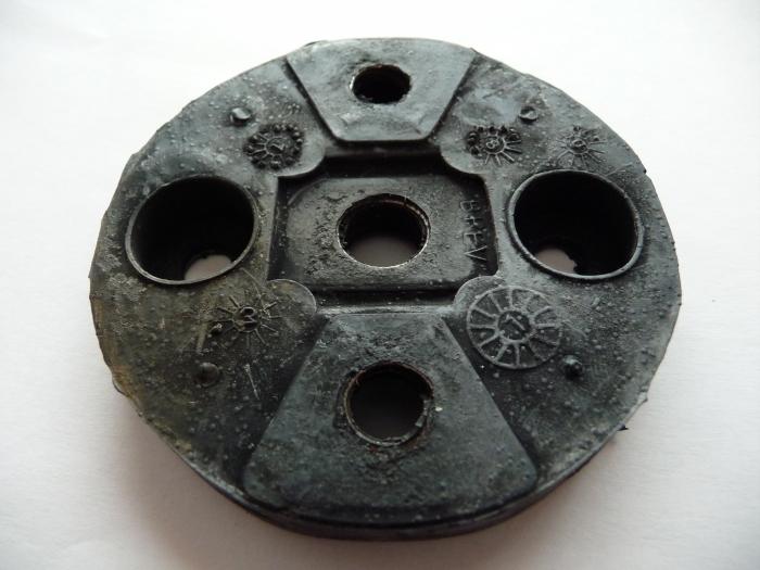

I have a hunch that a PSA (Citroen BX, Visa, Peugeot 305, 504, 505, Talbot 1508, Horizon, 1510, Solara) steering coupling could be close enough to fit. I'll go fetch one and post pics and measurements tomorrow. Cheap, 6.90 eur.

Rather roughly moulded rubber with steel inserts.
Diameter for the whole thing : about 74 mm
Thickness: thin parts 10.7 mm, thicker bits with inserts 11.7 mm
Center hole diameter: 10.4 mm
Outer holes, all four: 7.5 - 8.3 (some mould flash inside two of the holes)
Outer holes, diagonally across, center to center: 50.2 mm
I'll get more information on PSA part numbers etc. if it sounds right. It's mounted in a place that's a bit hard to reach unless I need to replace it (and currently I don't...)

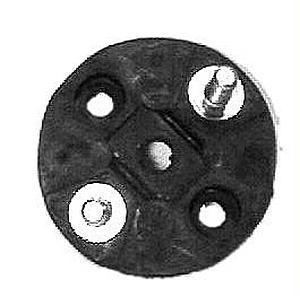

Here's an example of a Citroen steering coupling, with the two bolts included. This looks a lot like the picture in VADIS. If only the measurements are correct...
http://cgi.ebay.co.uk/ws/eBayISAPI.dll? ... 0268618073
For comparison:

That rubber steering vibration damper is a common PSA part. Peugeots, Citroens and even some Talbots and Simcas use it so those are available as aftermarket spare parts.
