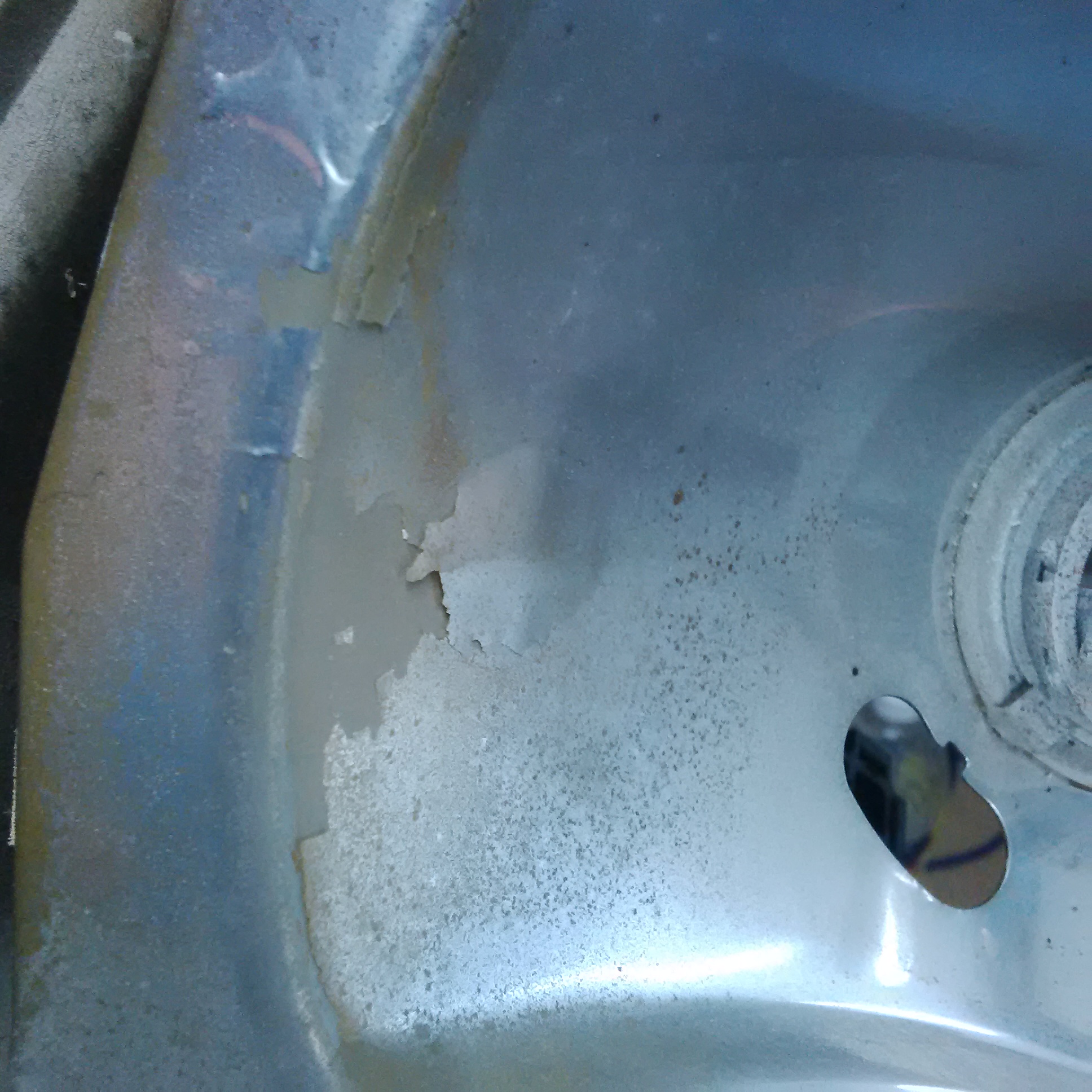

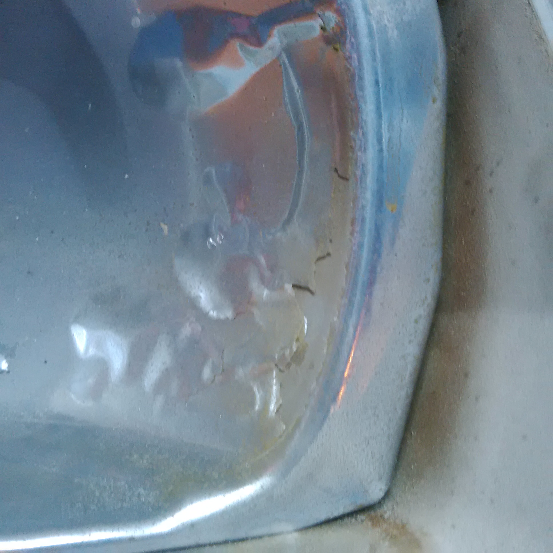

Thank you Joris. It's a collection of paint, cement and dust for over 10 years. The chrome flakes had already bubbled and fell when i remove the lense. i did not dare to touch chrome. Looks so fragile.

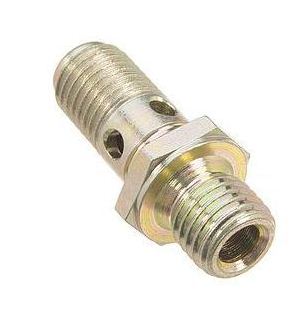

Hi guys..is this better or the stock ? If i use this the fuel will flow sideway right? our's goes straight..which is better? This is from audi quartoo fuel pump, i google it, i can use back my old joint but it must have dirt and fuel composite. Is this part serviceable?

Those fuelpumps are used in many cars, try searching for a Bosch fuel pump. Just make sure it can support enough fuel and has the right hose fittings.

Yeah the quattro pump is a Bosch one which is why I used it, now that I think about it I might have swapped the brass connections at the end from the 360 pump onto the quattro pump
