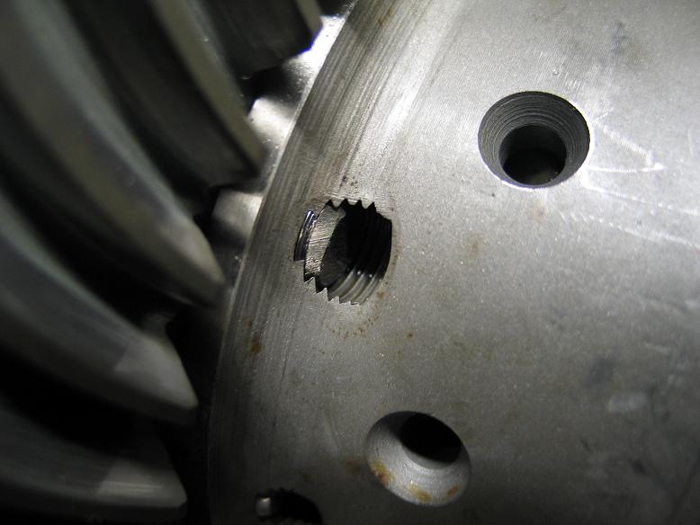

The original bolts are still too long and the thread depths are inconsistent, possibly due to the breakout into the side below the main rim. My tap also seemed to jam up. The originals are 35 and I think its been discussed we need 30. The brake carrier bolts are 32mm and do fit but it would be risky that some of the torque is going into bottoming out, to be honest I'm not sure the 30mm is enough to consider thread taper near the bottom. Anyway the brake bolts are unobtainium as are 30mm or any length really in the right spec. Socket caps are available but these are 2mm higher, much narrower head, no serrations. Also the shank is narrower than the thread so these are a bit special (although the brake bolts are fully threaded you might find tolerance issues). I can't tell at the moment if there is a spare 2mm clearance as I need the new bearings but it looks tight, so I'm considering modifying the rare original bolts which just seems wrong.
I also wonder what effect the different thread engagement will have on the torque, how much thread of the thin walled material can be counted? I don't want to see thread as this may start a crack in the thin material once the bolt is torqued up and it is pushed out into the hole in the side. Really the thin material should be cut out to leave a flat and strong end to the thread, or ideally leave the boss the same thickness as the original, but I don't know if this was done for a reason.

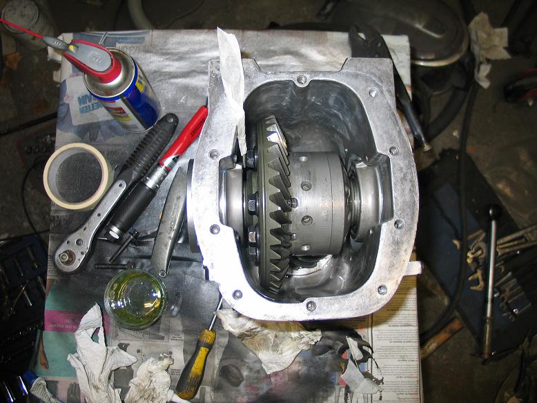

Well got the bits and got the main reassembly done.
Bearings dropped onto the crownwheel and new LSD with a bit of heat (180C), and the outer race the same into the aluminium bearing retainers. (outer parts heated, inner parts cooled if possible)

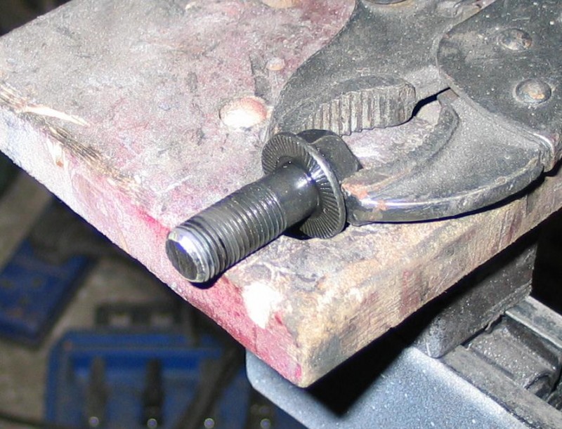

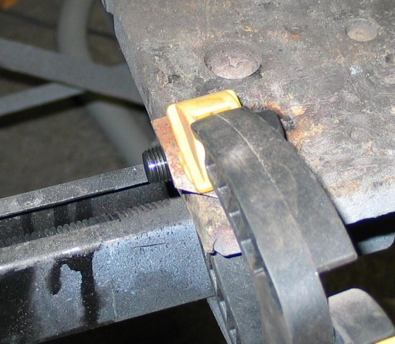

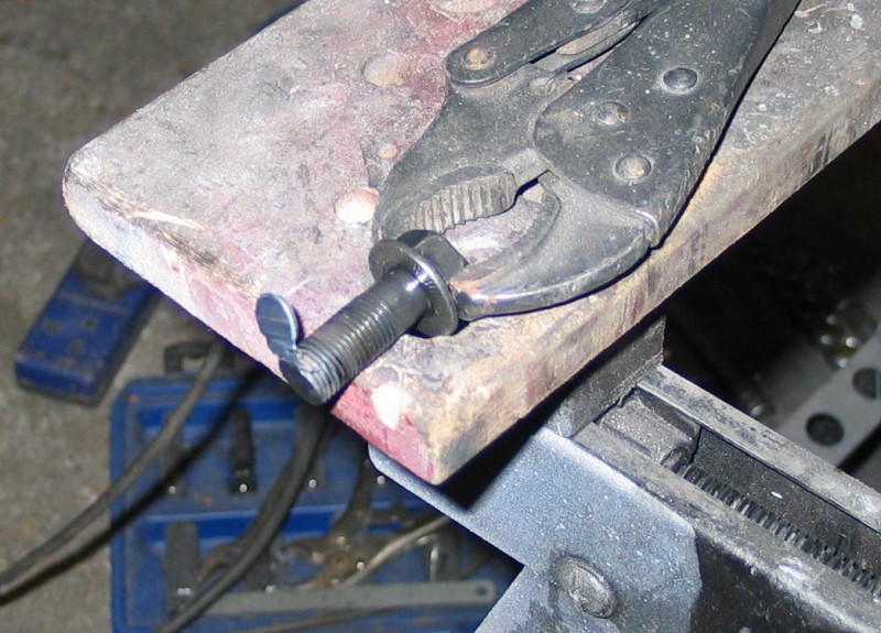

The crownwheel bolts had to be cut down to 30mm and a couple of long 10mm bolts (spare from rear springs) used to hold the crownwheel as the new diff is round. The original diff core has flat parts I could grip with the workmate but no grip method would work on the new diff. After checking with a drill bit, I think socket head bolts would fit as there is nearly 4mm and these would only add 2mm. Hard to check the rear but the main close part is the oil catcher for the top of the bearing. A standard socket cap bolt would not have the same flange or serration but it works fine for many other locations and does have the same contact area as a hex head (just not a flanged hex head).
The new assembly seemed a good level of 'stiff' and could be turned by hand at the wheel drive flanges(but not in opposite directions unlike the open diff), so I figure the pre-load is ok. I added a bit of instant gasket to the spacer both sides on the outer diameter to seal it up and keep moisture away from the steel-aluminium interface.
Holding bolt for cutting
Initial cut with big grinder
trimmed and bavelled with small grinder
about 1 thread left in this hole before bottoming out
