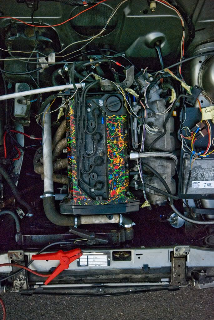

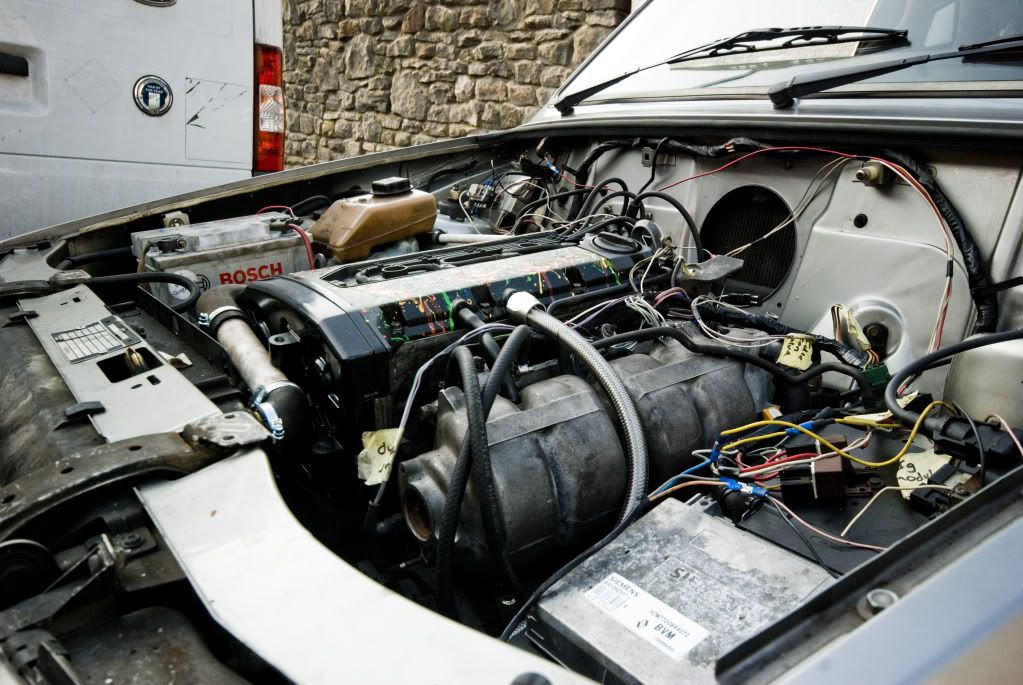

YEAH! Helper volvo! :lol: Even more pics. Was proper grinding the front valance on the floor ha ha.
Should be able to start it proper tomorrow.
Andy, I know ive said it time and time again, but this wouldn't have happened without your help chap! Thanks!

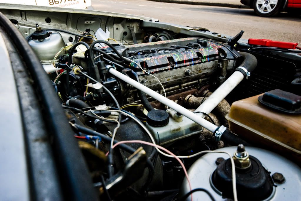

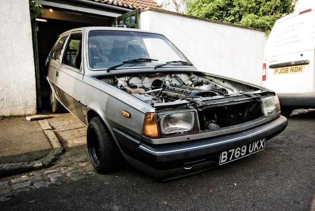

Thanks for the comments guys, its now finished (YEAHH!!!). everything works really well, and as it should. Drove it home with only the downpipe on :? Fooking noisy. I dont have the means to custom fab a downpipe, so some sort of bodged baffle will have to do for now :oops:
Had a problem of it only starting once, then never again. Turned out id earthed the sump, not the block (doh!, theres a gasket between the two, numpty) :lol: swapped that and problem solved. Adam was a big help! got a vid of its first drie my mate took somewhere, I'll try n find it. In the mean time, I'm going to bed, I'm shattered!

I was thinking that you could un-ravel your downpipe fabric, cut it somewhere along the middle and turn the part you cut off through 20 or 30 degrees downwards and then re-weld that bit in? It won't be pretty but it would work. Then that would be easy to fab something up for then, or you could just stick a motorbike can in there until you can afford a proper exhaust.
