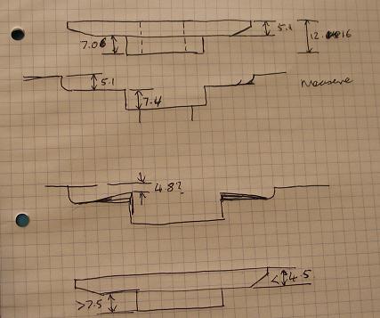

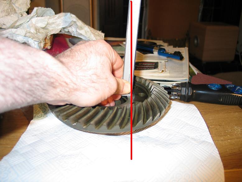

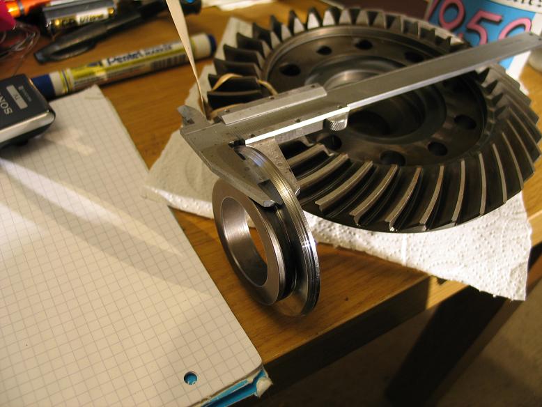

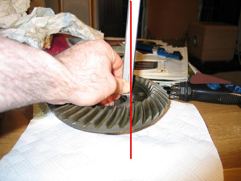

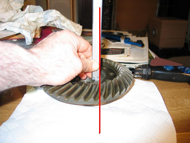

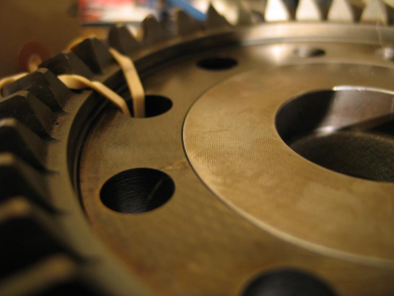

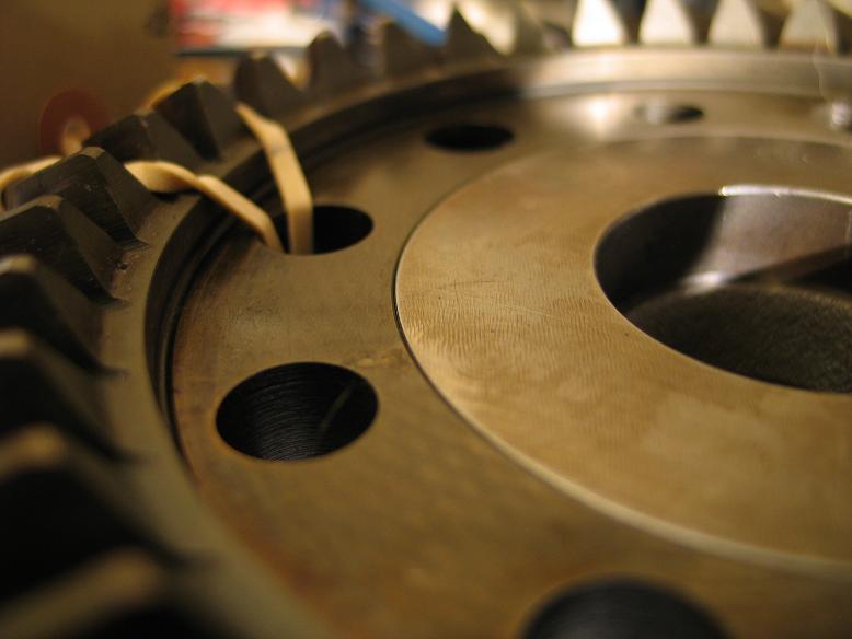

I've had a go at machining and basically failed to sort the problem, although the insert does fit better without heat, it is still not flush. We couldn't figure it out at the time and simple depth and thickness measurements did not seem to add up, and sure enough the diff bound up on assembly, however I think I've figured it out now.
The problem is that the 2nd step on the crownwheel is not a precision machined surface and is not flat (on mine anyway), if you take simple measurements you will end up with the wrong shaped part. Its cone shaped.
I think possibly the design intent was that the base of the insert would sit on the bottom on the bearing surface, but mine is short because when I measure the depth of the hole I am measuring from the peak of the cone. We did consider it might be something like this but knew with the cutting tools we had couldn't cut it anyway.
I suggest the middle surface in the insert be cut to float well above this surface. Say reduce the top part to 4.5mm and keep the overall height. It looks like it is only supporting the endfloat of the small gears, so doesn't need to be rigid at the outer edge but the designer would need to confirm.

Well good news so far. I took the insert and crownwheel to a machine shop and got them to shave off 0.5mm approx from the bottom of the wide part. This reduced the thickness from 5.1mm to about 4.46mm as per the last diagram in the previous post but didn't change the overall thickness (12.16mm). The part is hardened so needs ceramic cutting tools. They added a little undercut in the corner just in case.
The gives some clearance to the inacccurate surface.
The part is now nicely flush, I couldn't measure any non-flushness, and sure enough bolting up the crownwheel the diff is still free to move for the first time.
Reduced to about 4.46mm
Nice and flush
Nice and flush
I'd definitely recommend leaving the crownwheel with the machine shop with flush requirement, as this middle surface is not precision it may need a little more clearance in some cases. So they may need to adjust the diameter and middle dimension so that the base sits down properly in the precision bearing surface.

No they didn't modify the crownwheel (its hard to put in lathe with the bearing on, could be milled I guess), sorry I should have been clearer about that, I would only modify the new parts by default.
I just left the crownwheel with them to check the flushness, but my calculation for clearance worked out ok. Previously I had thought it was the diameter that was the problem but could not see the other problem until the first problem was corrected, so the whole thing needs to go for matching up.
