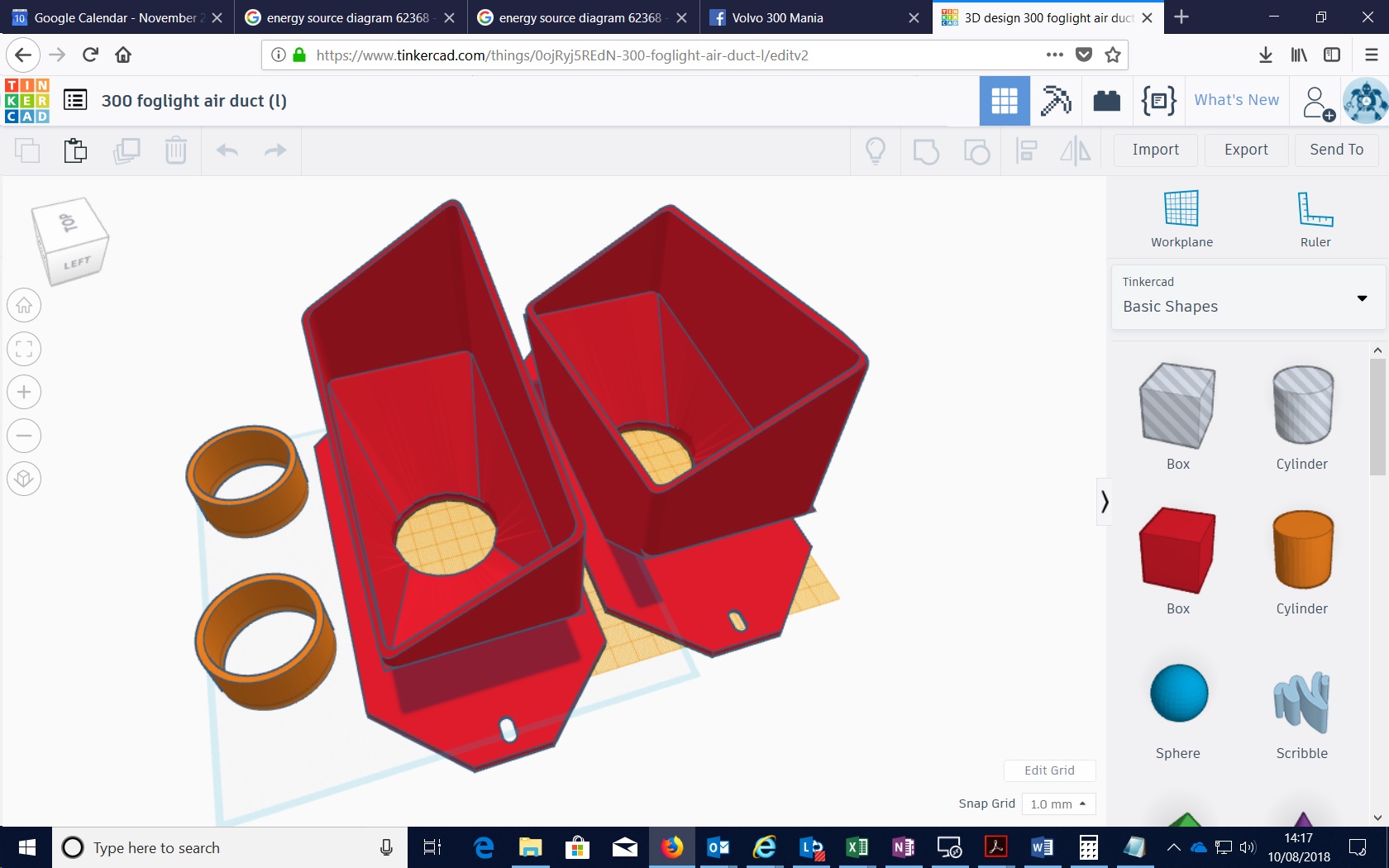

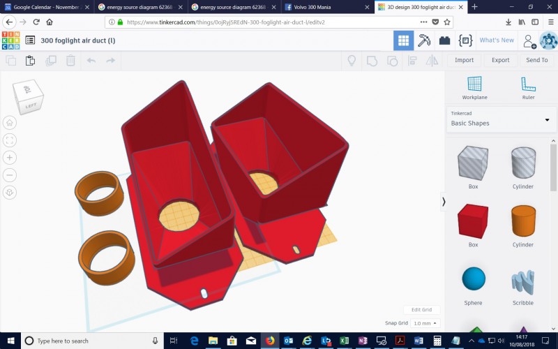

by Ride_on
Fog light air feed collectors
Fog light air collectors for brakes
Re: Brake Upgrades
Posted: 20 Aug 2018 12:53 am
by Ride_on
So I couldn't get the fog light air feed printed, our work machine wasn't big enough for the base plate and we didn't have time to print the scoop, so I tie wrapped the pipe in and duck taped it, but duck tape don't hold at 110+.
