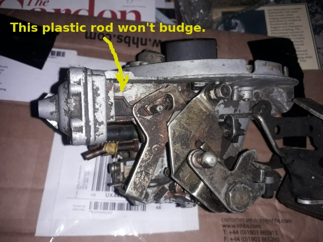

However, running under load was a different story with the stalling problems returning on the first real-world run out to the bogs.
So it is returned to the garage for further inspection. My latest theory is that one of the bellows is bogging and I think its this one.
That carburettor is posed by a model (not the actual one on the car).
Re: 360 carby fuel supply
Post by bogbasic »
An embarrassing correction to my last post - that plastic rod actually did move. Having practised the movement on my spare carb, I could tell it worked on the one still on the car. So I undid the 4 bolts that hold on the cover-plate of the bellows and popped-out the diaphragm with the plastic rod connected to it. The bellows seemed to be in slightly bad condition and a look at the photo below shows there is a crack in it on the right.
So I thought I would take out the same part from my other spare and compare the two. The diaphragm in the spare was in much better condition and looked almost new in comparison! In my eternal numptiness, I managed to break the plastic rod on my old one, so the better spare deffo had to go back on the car. A bit of brake cleaner was squirted about the place to clean out more of the passages in the castings.
OK, so the spare diaphragm goes back onto the car with its cleaned-up cover plate.
Looks familar! It's a bit scary playing around with these carbs nowadays, the plastic parts are quite fragile!
