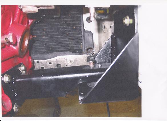

I have a picture here somewhere of a suitable arrangement. I'd be happy to email it to you for reference if you'd like to PM me your email address.
Re: 360 engine change
Posted: 20 Oct 2009 09:01 am
by Ride_on
Got the photo
Looks good, I had an idea it would be like that but useful to see the sides added for strength. I might try and use or adapt the 940 engine side bracket, but maybe it goes too low.
