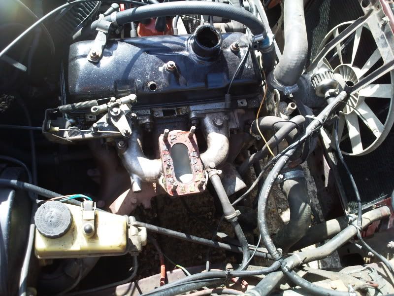

Ok so its been awhile and not much has happen'd, but since i got Adams carb and radiator i figured id go air leak hunting before i fitted them. so i replaced the radiator which was a pretty simple job and then removed the old carb:

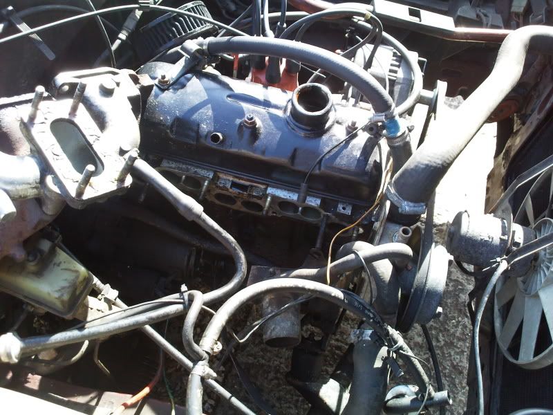

Then a miracle happened, something i truly never thought would happen. I removed the inlet manifold and exhaust manifold and down pipe, with no hassle
every bolt came off with minimal hassle

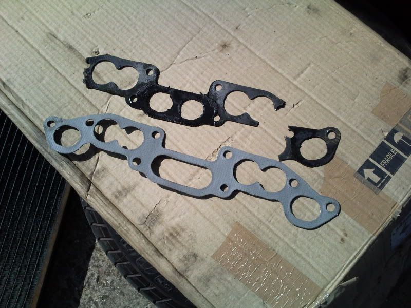

Heres the result:
Heres the old gasket compared to the new one:
So i gave it all a little clean and re assembled, by this time it was late, i went for a test drive and it still ran pretty bad and lumpy, which has lead me to believe that i havent tightened it all up enough, i sprayed with lynx today and it does pick up rpm so tomorrow i am going to do it all again
and use some gasket sealant to make sure there are NO LEAKS lol.
On a smaller note i also experimented with some polish and 2000 grit wet/dry paper, which is usually against all my beliefs but the results were promising and hopefully ill get some pics up for you all when i get the whole car done.
Cheers for reading Dan

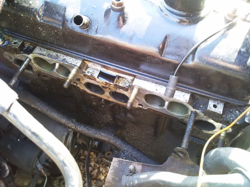

Heres the result:

While you are at it mate replace the rubber hose that joins the plastic pipe from the brake servo to the inlet manifold, these tend to perish and close up inside leading to very poor brakes; and can also cause an air leak.

Dan, its more likely you've left bits of old gasket on the mating surfaces. I'd give them all a really good clean, get some sort of blunt scraper, like a paint/wallpaper scraper in there gently to remove all the bits off, together with plenty of Carb cleaner, or white spirit/Cellulose thinners or other solvent to help dissolve off the stuff.

good work dude.pettaw wrote:Dan, its more likely you've left bits of old gasket on the mating surfaces. I'd give them all a really good clean, get some sort of blunt scraper, like a paint/wallpaper scraper in there gently to remove all the bits off, together with plenty of Carb cleaner, or white spirit/Cellulose thinners or other solvent to help dissolve off the stuff.
im sure youll get it running cherry soon.

Cheers for the help guys, Luckily im at my grandparents in from for a couple of days which used to be a motor works so lots of cool tools to help me with the task at hand. Ill get stuck in tomorrow and remove/replace everything and hopefully it'll all get sorted, then tuesday its on with the polish

Ok so i had the manifold off again today and got rid of every last piece of crud there, scrubbed the whole lot and then replaced it all with a little bit of sealant between the gasket, the manifold and the block, and it didnt make a single bit of difference, the car still idles somewhere between 500 and 1500 rpm and when ever i stopped at a junction it stalled.
So i have no idea what to do next, my engine really does suck bad atm
any advice would be greatly appreciated.

When was the last time your car had a new fuel filter dan?
