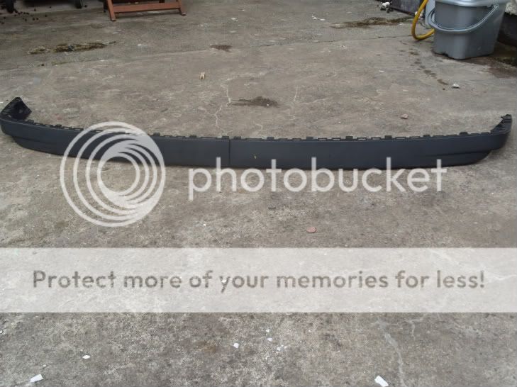

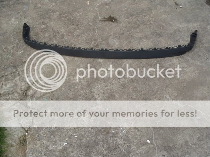

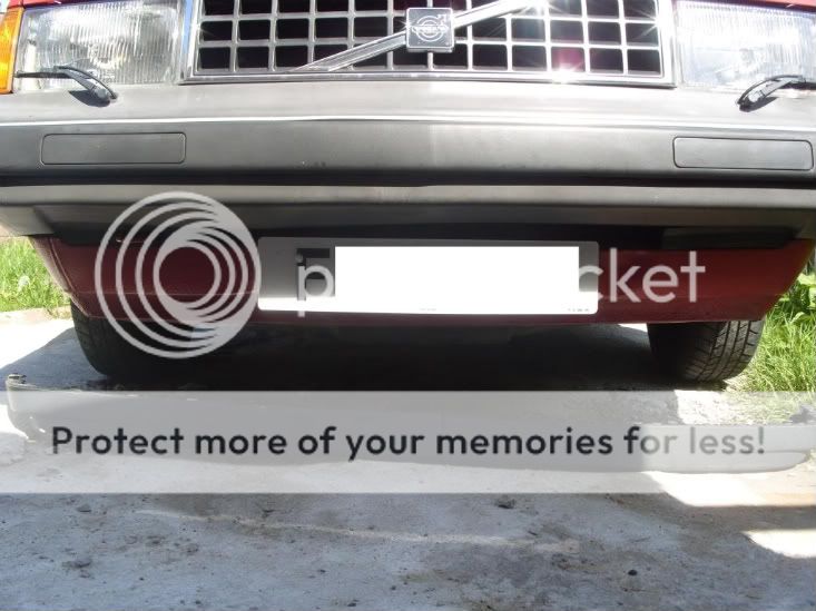

I Want to fit this VW Golf front splitter:
It adds an extra 5 - 10 BHP :lol: , well in my imagination anyway!...
I'm Thinking self - tapping screws and enough waxoyl to sink a small battleship behind tha front valance
Also its slightly larger than i need so how can i cut it a wee bit less wide then stick it back together then onto the car, I seen someone on here do it before and thought it looked good, cant rem who it was though!!, So if anyone has any idea's about fitting it leave me comments / post reply greatly appreciated! (Serious ones anyway). Thanks

I have one on my white car froma mk2 golf. That mk3 one you have will be a pain to fit because the corners are too round for the 340. You can cut a V ot of the top on the corner to be able to bend it sharply. To shorten it simply cut the section out of the middle and mount it on the car in 2 pieces.

Good one, thanks for the advice adam! 340pw

Putting it on as a two piece sounds like the way to go or
you try getting a 360 three piece.

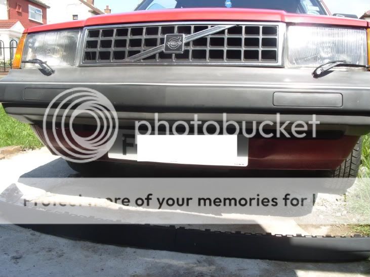

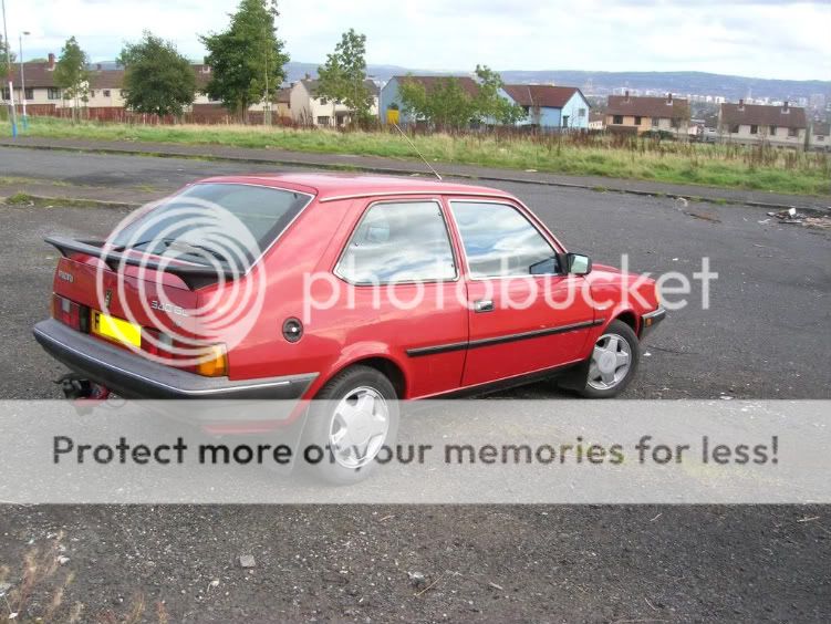

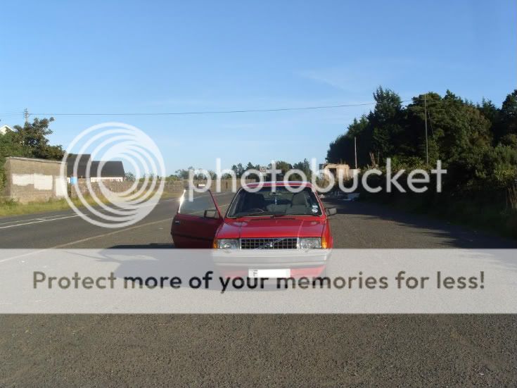

I did'nt know that a 360 has a 3 piece splitter, might have been easier way to go if i had known. Anyway youre comments were all helpful. And this is what it looks like now...
I like the end result!, I Think a square front numberplate could hide the join quite well (which isnt quite central), I want cibies and superlites, lowered, reclining buckets and heart transplant for my wonderful daily driver, but this will take time, i know, (If i ever get to that point) so in the meantime any suggestions on cheap easy mods welcome. I'm in 2 minds about the benefits of having a black bonnett, really cant be bothered constantly waxing, t-cutin the red one, as its like fighting a losing battle really!.
Thanks again for your comments!!!!!!! all comments considered!!!, Good or bad!!!. thanx!!!!!

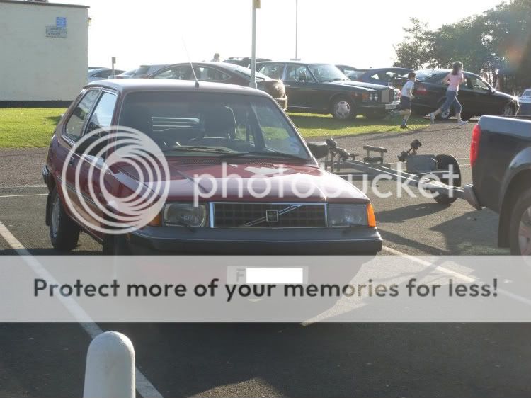

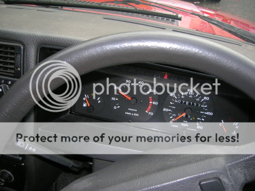

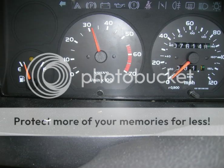

MCHUDD fitted a rev counter!!!!!, I seen him do it!!!, he's a volvo legend!!!
Works a treat!!!!
Also Clock in Centre Console!!!!, next to the all important cigarette lighter and ashtray (noticeably absent from all new cars) :?: :cry: (lighter and ashtray, that is....) how inconvienient if youre a smoker!!! :lol:
Also new wheels 14's
Well new to me anyway!
Could maybe start thinking about doin something now about the offensive ride height, factory stance, hideous highness, and wollowy ride!!!
Thanks for all your help MCHUDD!, A true fan of 300 series 340pw the best car ever made!!!!!. (Probably) :lol:
