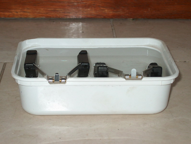

Floats are suspect!! One is way more floaty than the other... I'll upload a pic now so you can see how they are...

Jonofdoom wrote:Floats are suspect!! One is way more floaty than the other... I'll upload a pic now so you can see how they are...
then it's simple: order new floater from a renault or volvo dealer mentioning your carb number (maybe someone on this forum will have the number for the floater & a place to order it) make sure you adjust the floaterheight before bolting the floaterchambercover back tot the carb!
in the meanwhile, check all gaskets, membrames etc for tares or weak spots. now that you have the carb open this is the ideal time to do a refurbishment :D

Heres the lopsided float:
The fuel cut off valve thing works, I tested it by blowing through it.. Another float will be ordered ASAP!!

woow whahahaahahhaa that floater is cool :D
no seriously, i'm sorry mate couldn't control myself :lol:
membranes is the correct wordt according to a translation website? anyways, at the right of the idle jet solenoid there is one, covered with those 4 screws. i haven't worked on 1700's for a while, but there's a very good chance that there are 2 or 3 in total like on the weber. will look that up for you in my documentation, back in 5 min.
