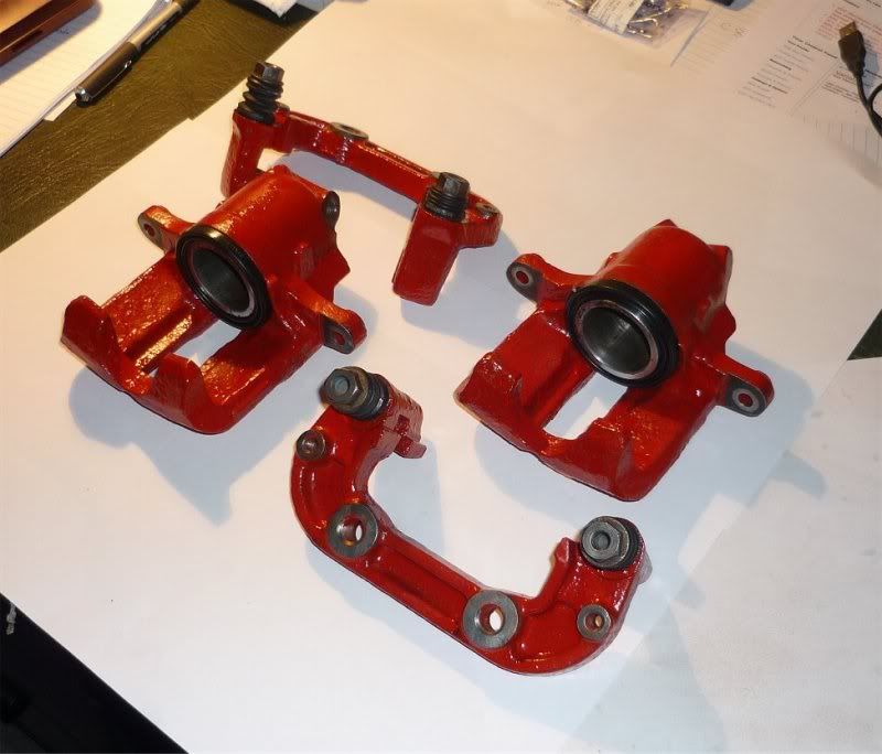

Calipers rebuilt and ready to fit,

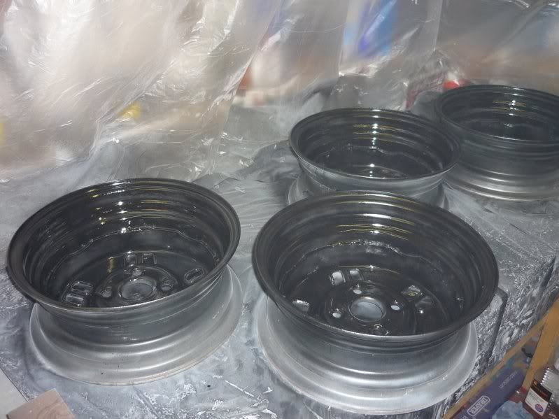

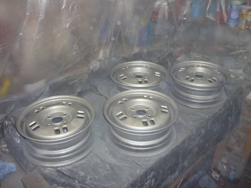

Wheels - blasted, primed with zinc rich. first coat of (inner face) gloss black.
Mac.

One last one for today - topcoat going on wheels.
Mac.

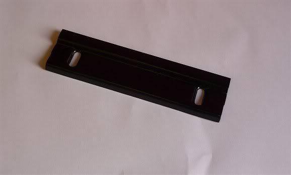

The missing piece of the jigsaw!
many thanks Adam!

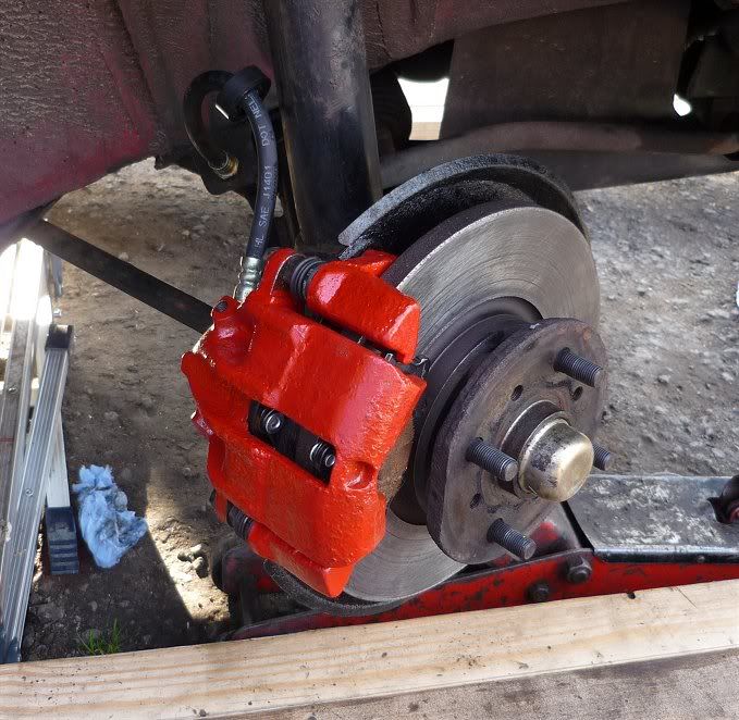

Brakes going back together,

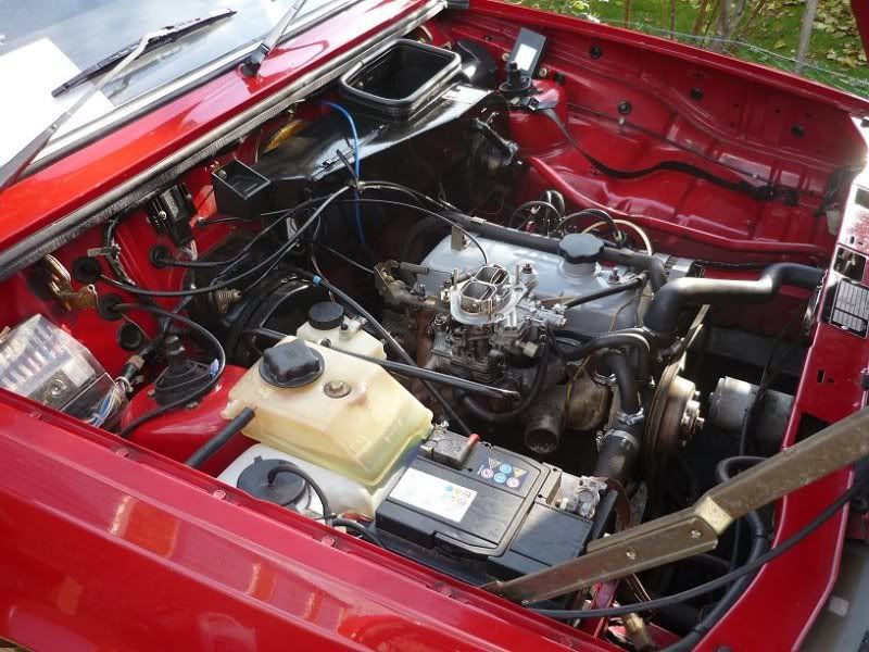

Final details of the engine bay,
from the N/S,
On its new tyres and refurbished wheels,
Brakes now done, engine run up and adjusted, lots of little niggles appearing - usual earth problems on rear lamps, indicators n/w (but hazards are fine), brake lights n/w (suspect switch). Still got to change the g/box oil and diff oil (will treat car to a "Mac" diff gasket kit). Washers were n/w (now fixed).

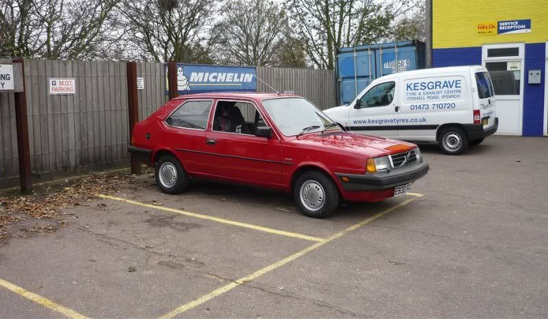

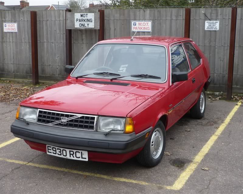

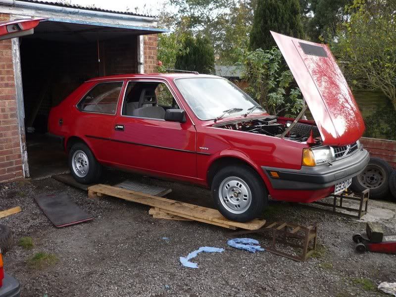

Looking all lonely and frightened,

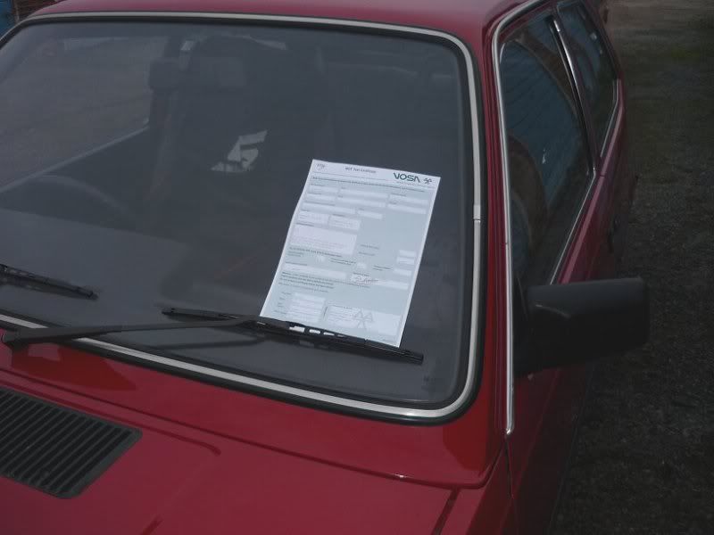

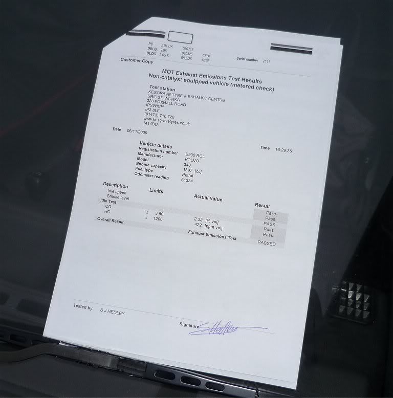

The tester (a young sprog fresh out of I'll fail everything college) fixated for some reason on the rear spring hangers (absolutely nothing wrong with them) and a tiny chip on the windscreen at the extreme edge of the swept area - nevertheless:-
woopie de wibble, bloop tiddle dee glook - dribble, more dribble - and no added advisories!!!!
And the emissions:-
This morning:-
Taxed - and another one saved - next please!!
Mac.
