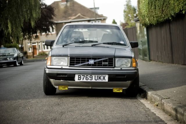

Got the front fogs on and wired up. Switch not properly mounted to the dash, but wanted to check they were working and whether my wiring worked, its did! So just need to mount the switch, and that's it.

Some pics of the fogs working . . . I realise it's very "scene" to put tape on the lights, but I had it in my hands, and wondered what it would look like!

Re: Derrick the Volvo! (Fog Lights!)
looking nicer and nicer! yellow fogs FTW

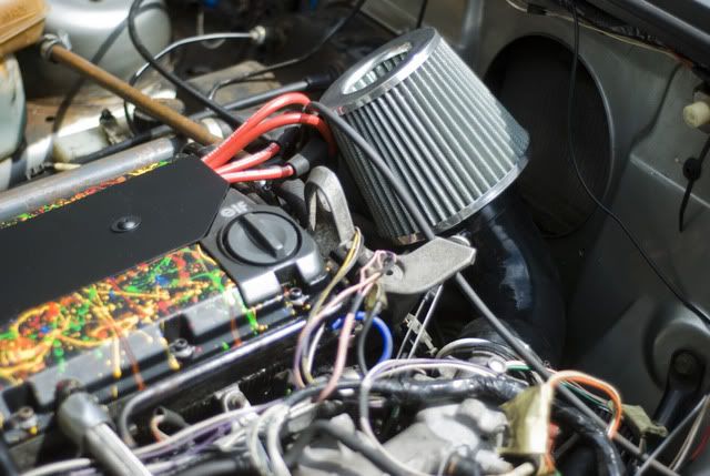

Just fitted the air filter. Uses a 90 degree 80mm - 70mm reducer hose, and fits neatly beneath the bonnet vent. It's nice to have an actual filter on the now, I was always a little unsure of the tights, but they did the job well!

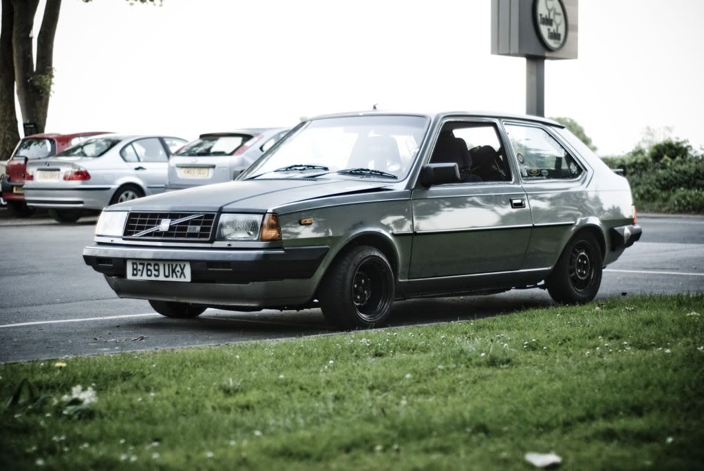

whats she lowered here. 3 front / 2 rear? cause youve changed the back now havnt you?
jon-ovlov wrote:
C25 ECV-1985-Mk2 340GL-Kessy
A889 VUY-1983-Mk2 360GLS-RUF
Best appreciated when open.
HE is lowered -3" front. 2" rear yeah. Raised to standard at the back atm, as the old leaf springs were sagging. I'm going -1" when the coil-overs are done.
