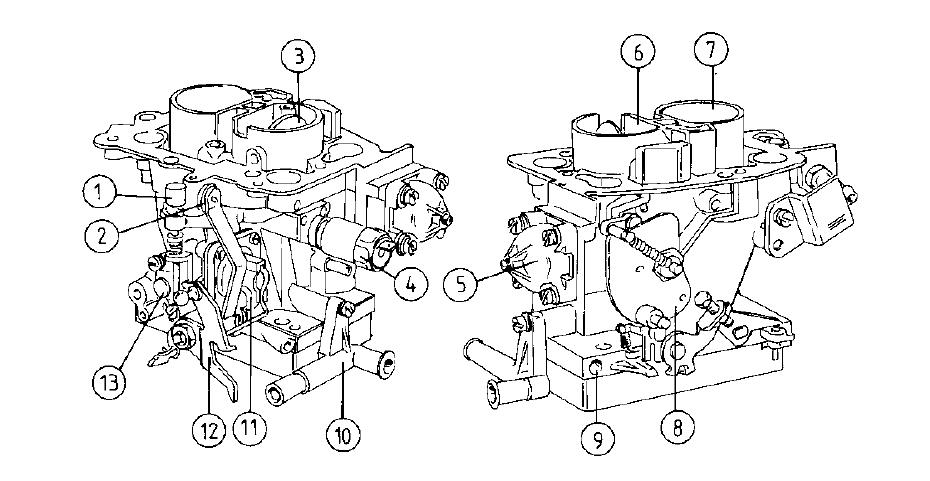

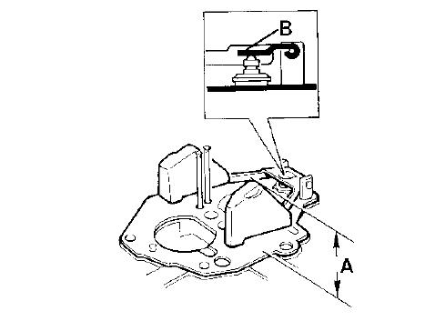

back again, this will help you i'm sure!
this is how you adjust the floaterheigt:
bend lip B so that size A will be 33,8mm.
also check the floaterchamber breather, distance A should be 2/3mm without applying throttle! if needed, adjust lever B

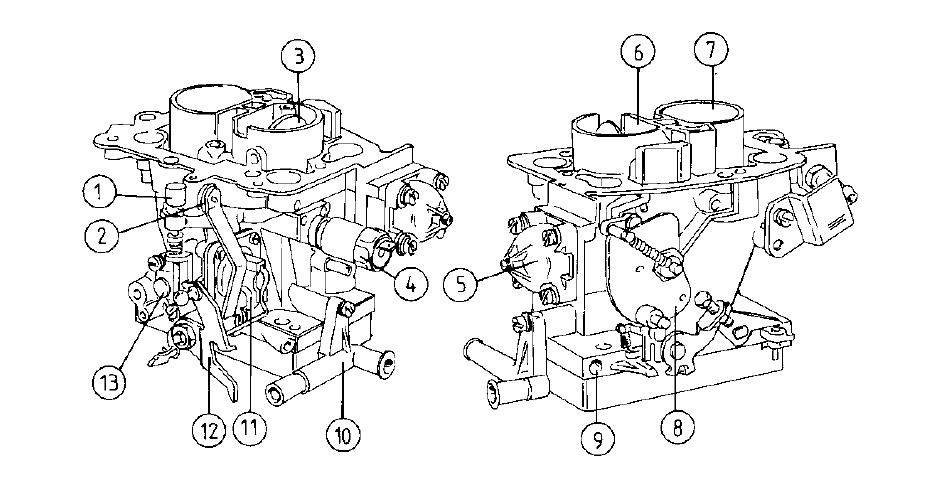

the "membrames" are at numbers:
carb 1700.JPG (85.87 KiB) Viewed 6246 times
11 - accelerationpart membrame
5 - partial load membrame
next to the idle jet on 4 i believe the 3rd membrame is located, and that will probably be for the pneumatic choke mechanism like the weber 32 dir has, don't know that for sure though

ah cool! you found it allready :D best way to check it is to carefully completely remove the membrame, and moving the center of the membrame to the other side (the axial action the membrame performes), this way you can see if any tiny holes etc are present.

yes, i think so too. the floater will be the reason why it doesn't start too well. the floater is leaking so the fuel jet at the entry point of the carb won't get closed when proper fuel height is reached. the floaterchamber will get way too full with petrol and the petrol will be tossed into the venturi chambers uncontrolled whithout applying throttle.
with luck and without applying choke you can still get it started, but the mixture will be way wrong so fuell consumption and performance is very, very poor!
