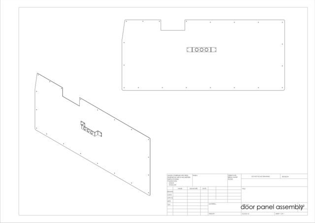

So while the prop company make a new prop for me, thought I'd try and sort out another thing that's been getting on my nerves a bit. Door trim. The chip board panels have pulled and are beginning to fall apart, (driver's side especially). The passenger side is ok, but rattles a lot. They'll be replaced with aluminium panel, with gaps in it for the door pull etc. I'll make the door handles to look like this: http://shop1.actinicexpress.co.uk/shops ... &search=Go
On my side they'll also be a fire extinguisher bracket at the bottom right, and on both doors there'll be a pod for a speaker (bottom left). Been measuring today, I'll do the first panel and door handles tomorrow.
Here's the design for now, not much to see, just a flat sheet
It'll be self tapped into the door, at several points to strengthen it and to prevent it from rattling.

Re: Derrick the Volvo! (Door panels . . . )
that'll look cool! how about small rubber washers aswell?
Only thing i can see is that where the original handle/tray thing is, there's a bracket below which that handle/tray is screwed into. That would need to be removed for your panels to fit (i think). Looks like it will be dead good. Fire extinguisher's a good idea too, i've got a genuine volvo 240 in my boot, was just too big for between the door and seat.
Rubber washers - good idea also, stop rattles vibration.
