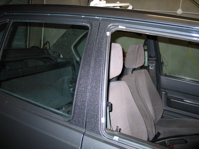

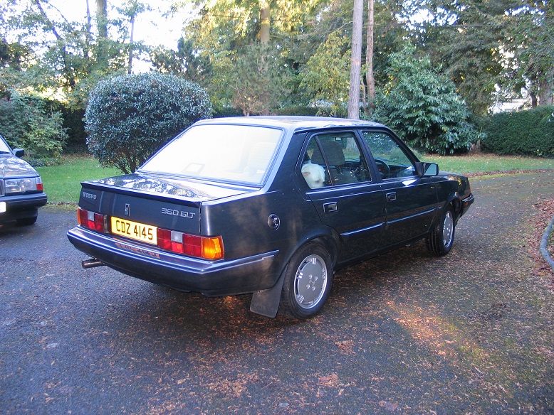

Took some picks for notes for the sprayer defect list. Looks good from a distance.

Can i come over to Hollywood and steal it lol. Looks great.

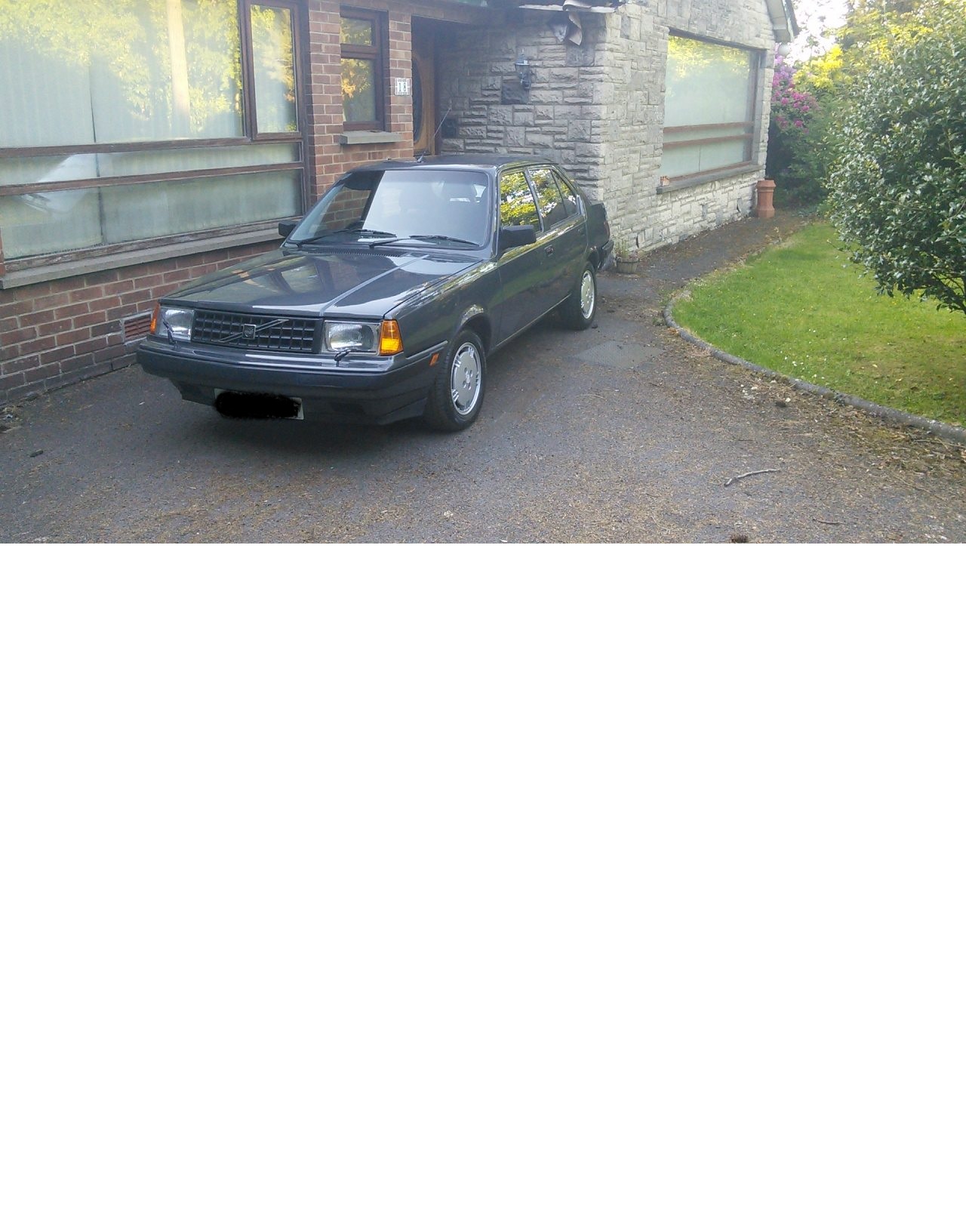

Looks really good, what defects do you have to tidy up?
Re: 360 turbo saloon tidy up
Think it was a bit of a rush job, there is a long list, from lumps/inclusions to white spots, unpainted edges and wet gouges or poorly prepared flatting. Anyway he did offer from the start to do a touch up after I had rebuilt it, but there are about 30 painting defects and I added one chip.

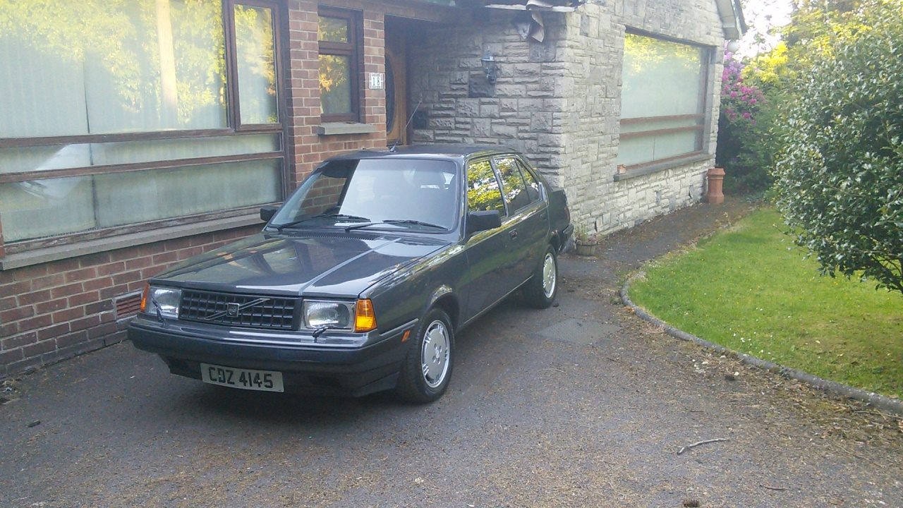

Well its finally back from the painters after being touched up. Better than it was but not a manufacturers finish as requested, it will have to do. So need some inspiration to get on with it now.

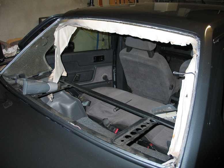

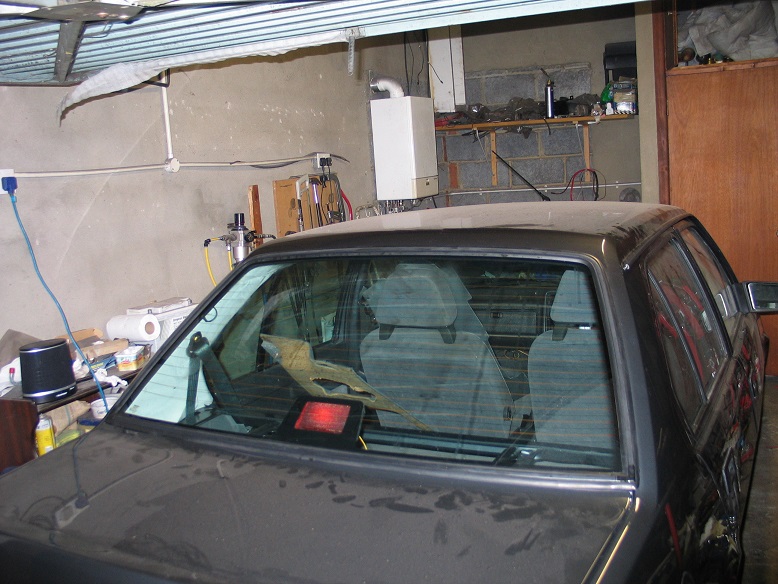

Main job now is to get the headlining done so i can get the back window in.

Time for a few more updates and some time off work with some progress on the car.
As posted in the clutch upgrade thread, the clutch plate has now been changed from the Audi friction disk to the thinner Astra F20 friction disk and cured the slipping sounding like an automatic. Bit of an ebay win at £8 delivered but slightly used and a bit rusty.

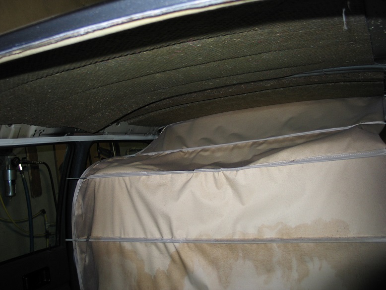

Still working on the headlining, ebay seems to have a random line pattern off-white non-perf which would probably do, but the original seems more like regular moonstone pattern (rather than the random moonstone). Waiting for a few more samples to see if I can match it. Strangely my trimmer is not that interested in sourcing material and seems to want to wait for material samples to magically appear so I am having to sourcing it myself, but he is at least cheap. £60 + material but I have to fit and trim, saloon is a bit annoying being glued. Should be sorted in the next few weeks.

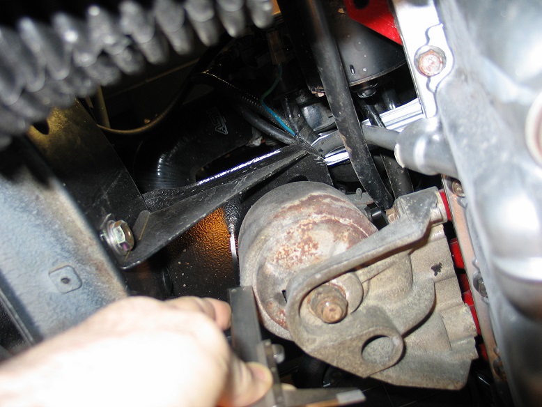

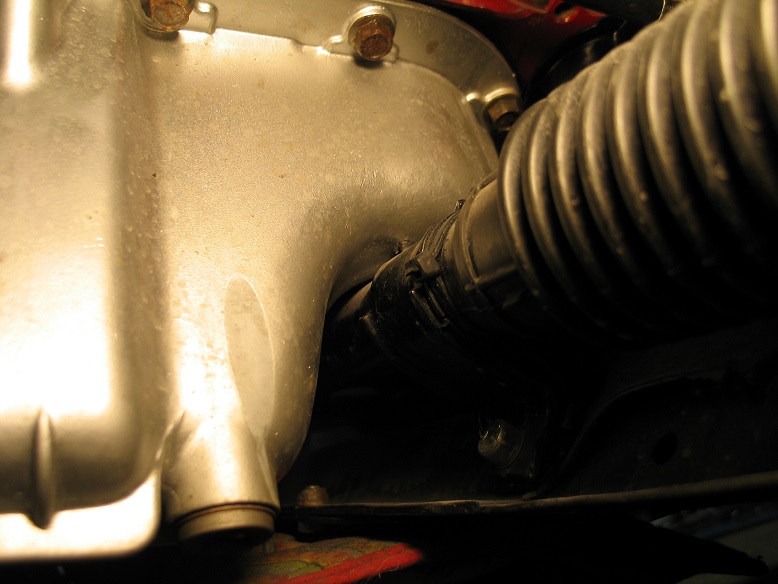

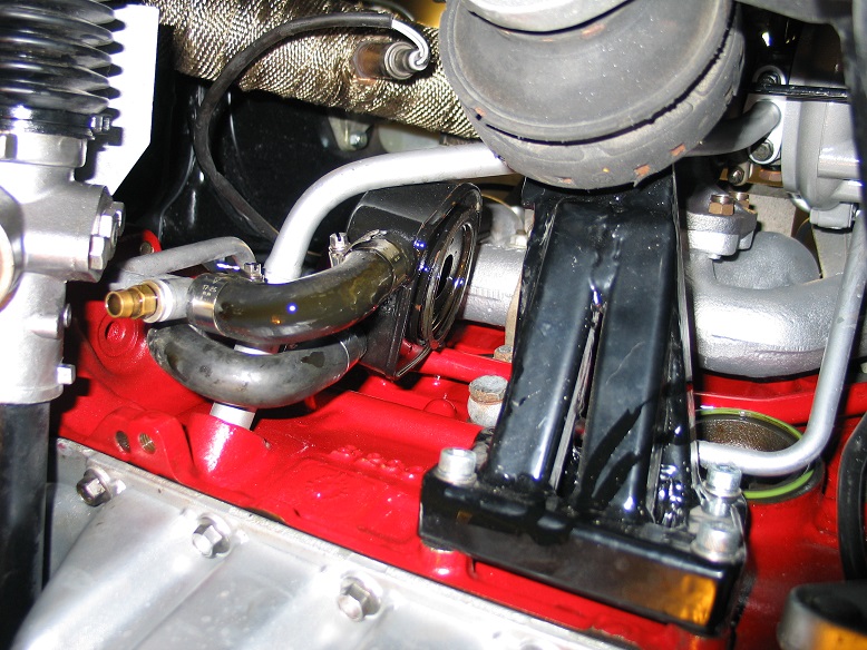

Also Engine seems to be sitting on the steering bracket/rack. Not sure when this happened, original mount is a bit saggy

September updates:

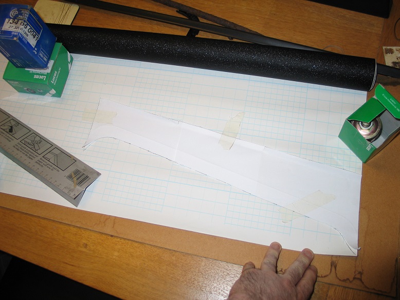

Got the new headlining, only cost £40 for the labour (to make it) and <£40 for the material. Glued in around the rear window and doors and trimmed. Quite tough to get in. This then allowed the back window in, didn't realise it has a brake light, but wired this up and fitted a red LED bulb. Speakers and rear parcel shelf and back seat followed.

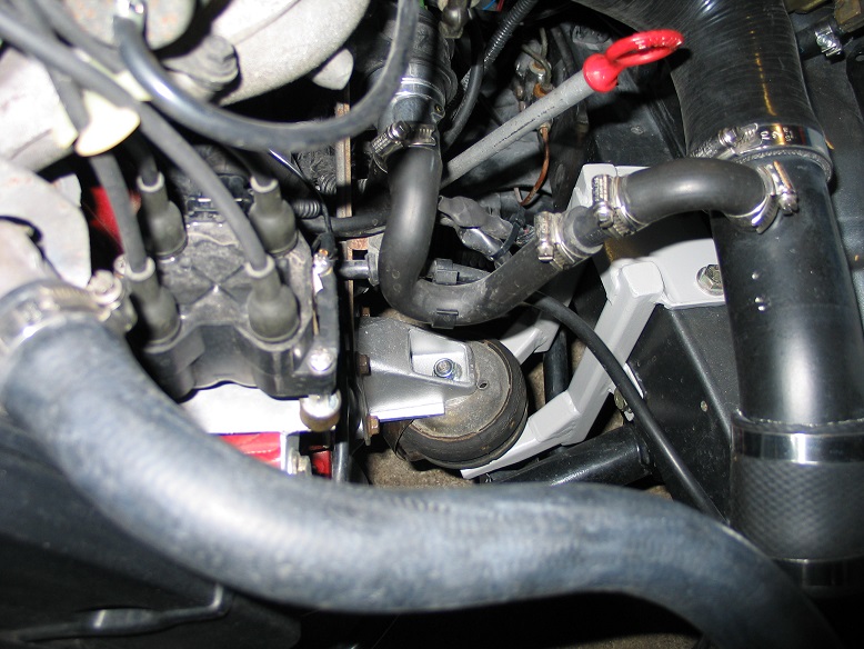

Fix the engine height issues from the failed remaining 360 mount using 940 parts and fabricated chassis side.

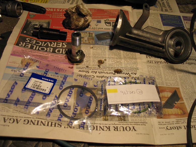

Fixed the oil leak

Uprated ARB-steering arm touch issues also resolved with longer bolts and tubes, all stainless and heavier section than the steel stuff supplied (which refused to dissassemble after only 2 drives in salty winter roads).

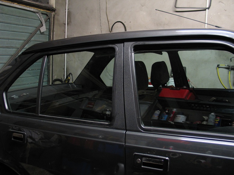

Window trims and door bumps also added, doors bumps are not great condition, letting the car down a bit with scratches and whitening so are going to need gel/oil wiped for shows. Tried rubbing down and T-cut but no significant improvment.

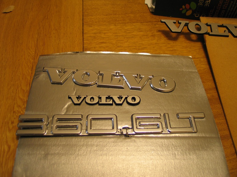

Working on badges at the moment, have a process for spraying but need the right paint. And soon to rebuild rear lip spoiler with a new rod.

This looks great, please may i ask where you got your headliner made?

It was a local trimmer in Belfast. He just copied the original, reusing the plastic edging. I'm sure any trimmer can do it.
I got 3m, hatch maybe less needed, also easier to swap out with a good original as I don't think there is any gluing.

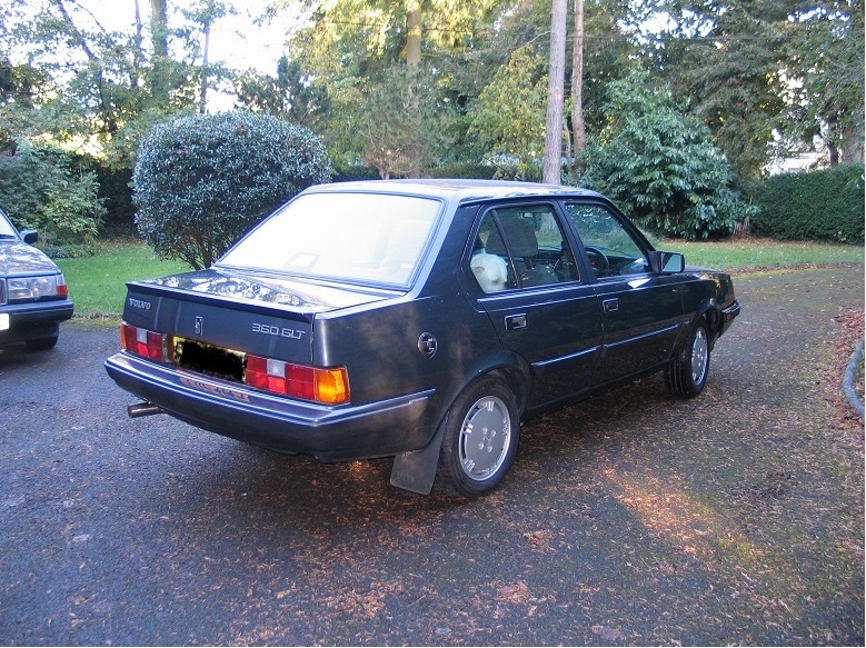

Some more updates, getting the boot together.
Spoiler I had was rusted and broken.
Rod was then glued in with 2hr epoxy, rubber has previously been derusted, which it pretty hard, lots of rust lumps stuck to the rubber. This is a hard process, took a lot of time and the result was not perfect in the end. The rod has to be exactly the right shape, including the end squashy bits and the studs welded on at the perfect height.

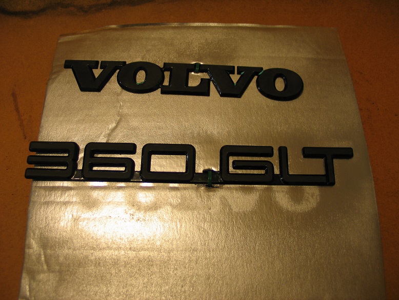

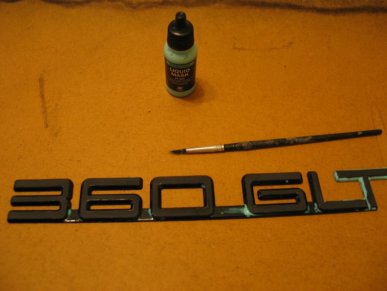

The badges were carefully rubbed and scraped to remove the liquid mask and make a good edge for the paint against the bevel. Chrome paint is very delicate and you can't lacquer it, just goes silver, so we'll see how well it lasts. I used Promatic, which is a bit brighter than original so all the badges have to be done.
Injection badge still to go on, big thanks to Steve for the badge, and big thanks to Mark for the Volvo Badge.
For positioning the badges are justified to the boot edges with about 28mm in from edge at the top of the letter and about 83mm from the bottom edge and aligned with it (don't try to use a spirit level).
Anyone got the measurements for the injection badge position? It looks aligned with the GLT end and maybe halfway up.
Also the wing badges would be useful.

Looks so good in that final pic!
I'm not sure if the Injection badge positioning was the same on the saloon as the hatch? But if the hatch is any use I can grab some pictures and measurements.

Absolutely brilliant, are you going to get any coach lines on it?
I can get measurements for the badge on my saloon tomorrow, it does sit level with the end of the E on GLE on mine.
