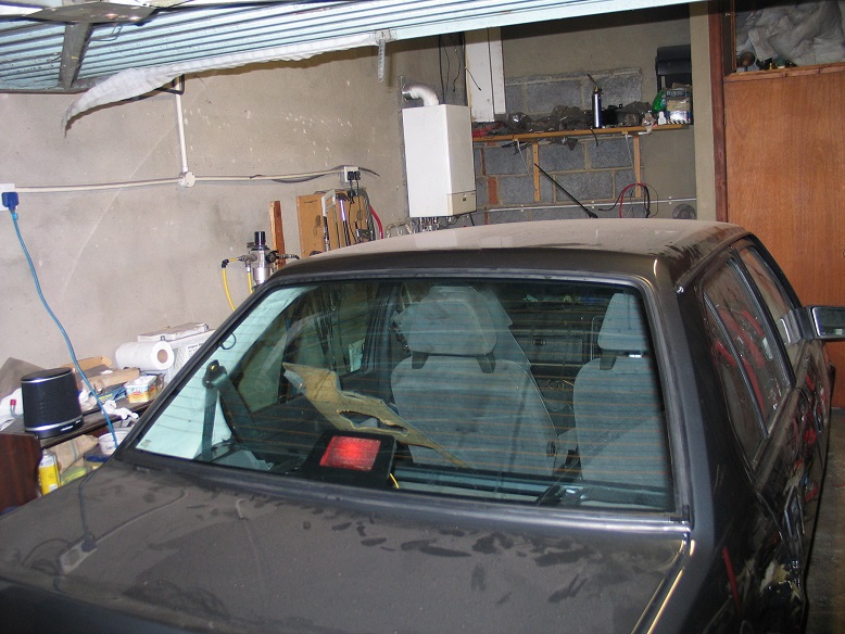

Got the new headlining, only cost £40 for the labour (to make it) and <£40 for the material. Glued in around the rear window and doors and trimmed. Quite tough to get in.
Headlining glued in
Headlining glued in

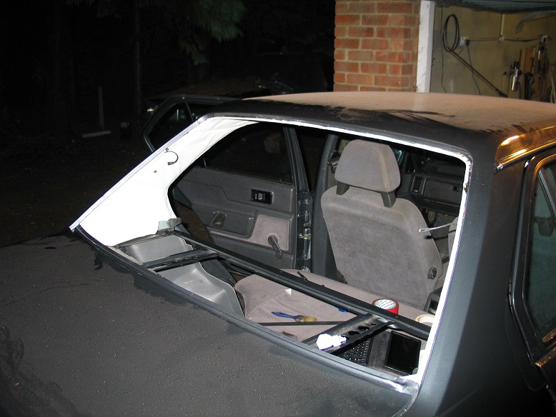

This then allowed the back window in, didn't realise it has a brake light, but wired this up and fitted a red LED bulb. Speakers and rear parcel shelf and back seat followed.
Back window in
Back window in

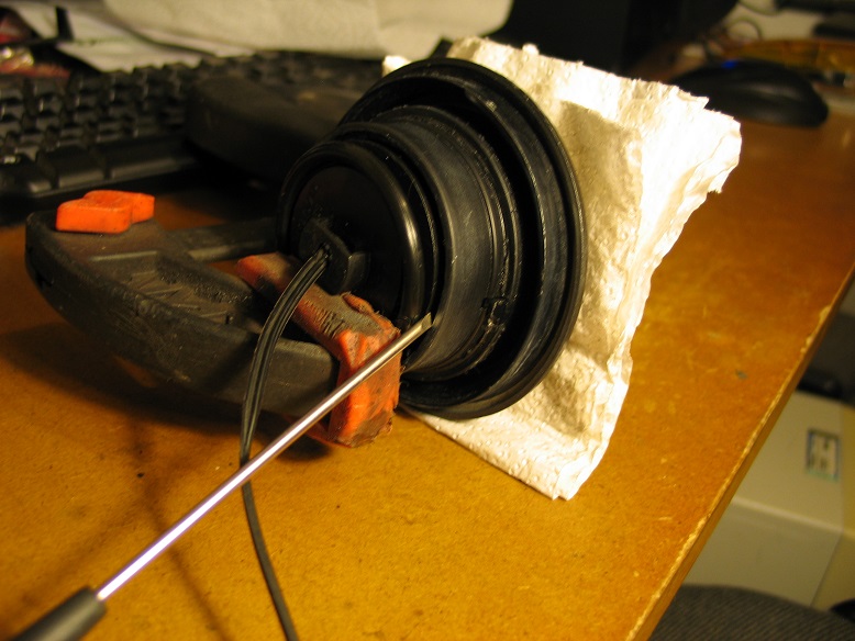

Proper painted fuel cap finished with recoded rebuilt lock, reassembly is difficult, treat it like a tyre.
Reassembled the fuel cap with the recoded key

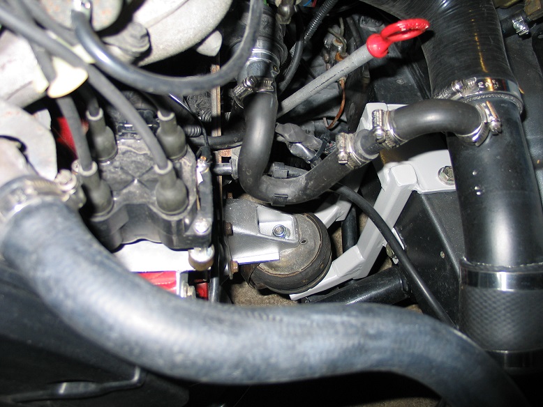

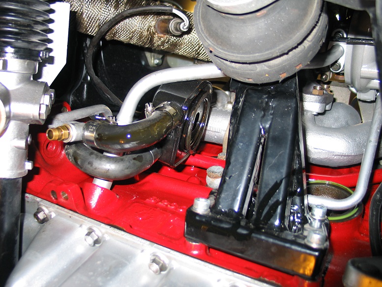

Fix the engine height issues from the failed remaining 360 mount using 940 parts and fabricated chassis side.
Built 940 sit-on engine mount for left side

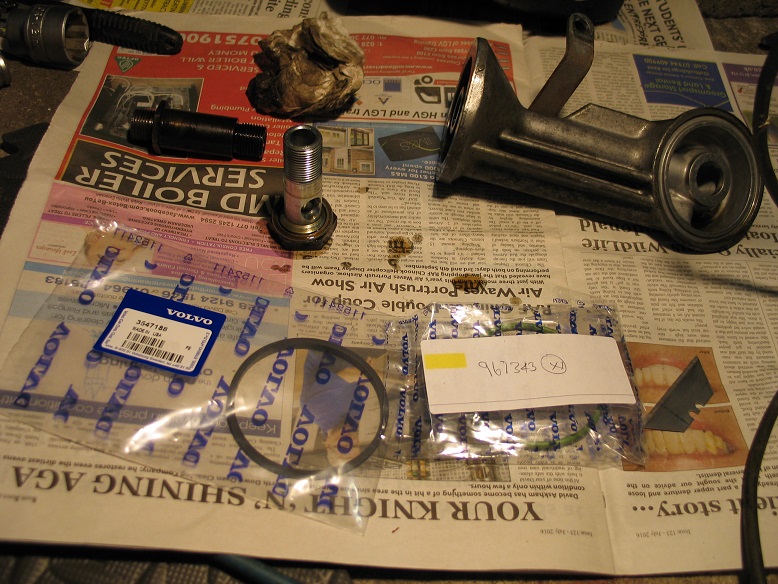

Fixed the oil leak
Replacing the oil cooler seals
Oil cooler parts
Oil cooler parts

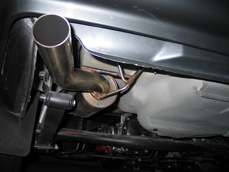

Got a custom stainless system. Its louder than I intended using all straight through, but I'll enjoy this for a bit until I get stopped ;) Its not super loud and quite deep.
Also noticed that the 360 and 940 both have narrow tail pipes as standard, so the 360 now has a wider tail pipe than the 940. Looks a bit suggestive, and em.. arousing.
Stainless powerflow 2.5&quot; system
Stainless powerflow 2.5" system
