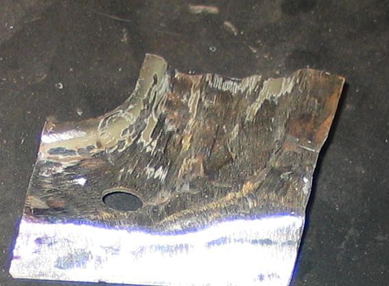

Not enough posting going on so I thought I would provide some entertainment. Anybody able to identify this piece I have cut out and repaired?
Re: Dreaded rust
Post by macplaxton »
Something reminds me that that is a inner piece to the bottom windscreen corner. There's a few layers there and it's one of the ends of those layers in the sandwich?
Re: Dreaded rust
Post by foggyjames »
Agreed - I think it's the inner skin in one of the bottom corners of the windscreen, although it's long enough since I had a dash out that I can't work out which corner, or the orientation!
Re: Dreaded rust
Post by MCHUDD »
Two windows must mate it right :lol:
Havn't a clue though.
Cheers Mark. sm69 sm69 sm69 sm69
Posts: 2266
Re: Dreaded rust
Post by Ride_on »
Nope, I wouldn't be so obvious. It is a piece you can easily see, but not all the time. It did have paint on most of it.
It is cut out along the top and left side of the picture, to be welded back in along same lines.
Re: Dreaded rust
Post by MCHUDD »
Is it part of the door step thingy?
sm4 sm4 sm4 sm4
Re: Dreaded rust
It's either that Mark or a piece of the tailgate thingy. Not many other places for a seal flange :?
Front of the door step thingy nearside?
Posts: 2266
Re: Dreaded rust
Post by Ride_on »
More like tailgate, but could not be further away.
