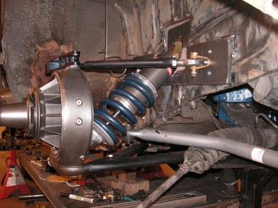

My new suspension, made only from f1 parts sm4
peter schmidt
Posts: 48
Joined: 25 Nov 2009 06:20 pm
Re: Peter Schmidt's newest build
Post by peter schmidt »
pic

That is indeed very impressive :shock:
I got some silly questions :)
From photos I see 4 links at rear axle, but there must be 5th behind rear axle to stop sideways movement?
What are spring rates and corner weights in this one?
How much wheel travel you get (front/rear) with this setup?
Are you aiming much higher than 2Hz natural frequency?
peter schmidt
Posts: 48
Have not been here in a long time, have no measurements revalued unfortunately.

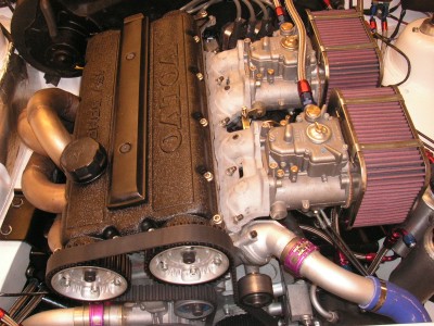

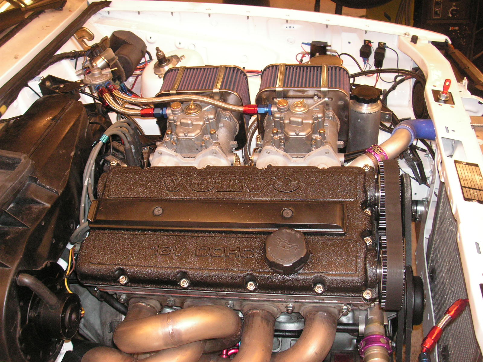

We have finally started Camilla's new engine. The engine is built on
b230fk block that is bored to 97mm and fitted with forged pistons and H-profile rods.
97mm pistons + 98mm strokercrankchaft = 2.895 liters. Weber 55mm carburettors, 39mm
Titanium intake valves, 34mm stainless steel exhaust valves, 310 degrees duration on the exhaust 12mm
lift. 320 degrees duration at intake 12.5 mm lift. modified header from Formula 1.
