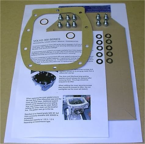

UPDATE
Getting there at last - the gasket kit as it will be available.
Final pricing structure - this is after considerable negotiation with suppliers (and myself to curb my commercial instincts !).
Gasket (1) £1.50 Copper seals (2) £0.70
Capscrews (10) £1.10 S/S washers (10) £0.30
Packaging £1.00 Post (full kit) £1.27
The kit costs out at £3.60 + £2.27 p&p (at the risk of being accused of profiteering I shall round this up to £6.00.
A gasket alone (with copper seals) costs out at £2.20 + £1.65 p&p which I shall round up to £4.00
My budgeting relies on a run of 50 gaskets (to cover my costs only) at the above prices (to v3m only). I shall also try some on the bay, but at a rather higher cost.
Payment by cheque, P/O, cash, or paypal - but no strings of beads. Contact me initially by PM and I will confirm cost and payment address.
If multiples are ordered in one package I shall adjust p&p accordingly.
I am still rather tied up (family in hospital wise) but I should be able to supply from the middle of next week. (sorry all this has dragged on a bit).
Note - as previously stated to keep costs resonable I have substituted BZP 12.9 alloy steel capscrews for the original S/S.
Hope above meets with approval - Mac.
