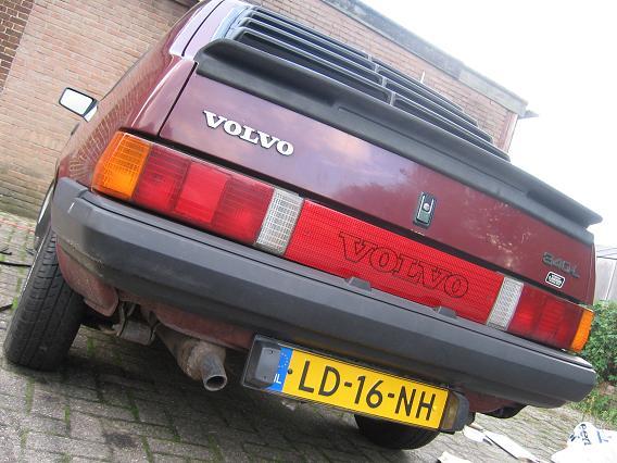

Frits had if on his 340 for a while:
i'm going for rear spoiler + louvre too but with the volvo emblems on the tailgate, mudflaps AND even on that reflectorplate it's just a little bit too much for me

Yeah, I agree ... Fitting every exterior accessory there ever was does make a car look a little strange
I still haven't decided about the rear louvre on my 343. Next month I need to visit Mr TÜV anyway for the historic plates and will ask him about that, it's one of these "needs to be added to the cars' papers" accessories.
