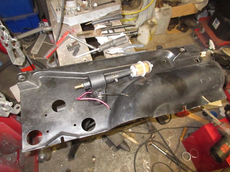

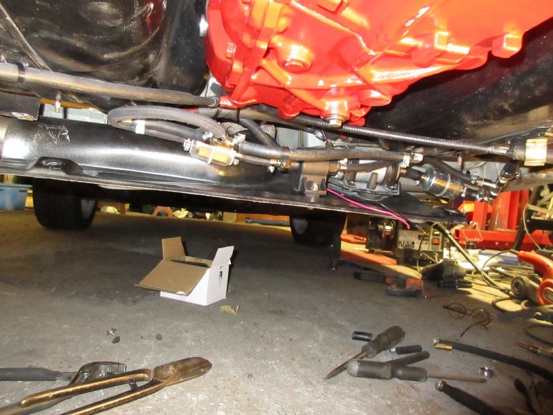

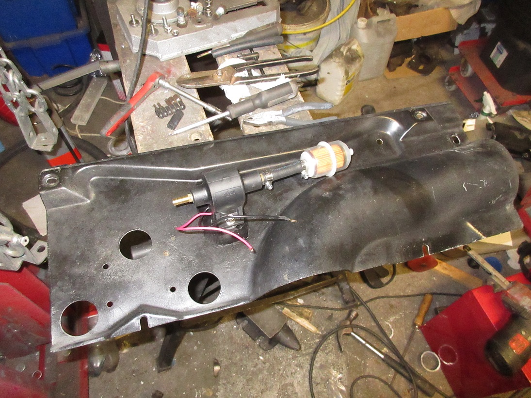

Fuel mods
Trying to pump up the leaky swirl pot in the tank with some success. Taking the lob joiner pipe and pumping from that into the inj pump inlet and the tank. Helps me down to about half a tank now, but then starts spluttering briefly on some corners, and recovers quickly. Have found a place above the gearbox for a small custom spirl pot.
Found space for a pump
little bit of pumbing

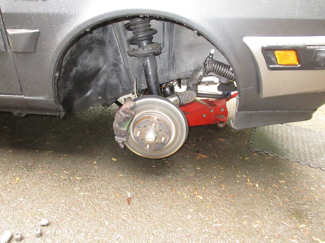

Brakes
Increased to Mercedes A class 276mm disks and calipers, still problems to resolve.
Bigger disks
Bigger disks

Looking good Tony! Surprised you didn't feel much difference with a cam swap, the 'T' cam felt as flat as a pancake above 5000rpm in a 940 I once owned.
Great work on the brake conversion, they're a much more appropriate size for the amount of power you're running now!
