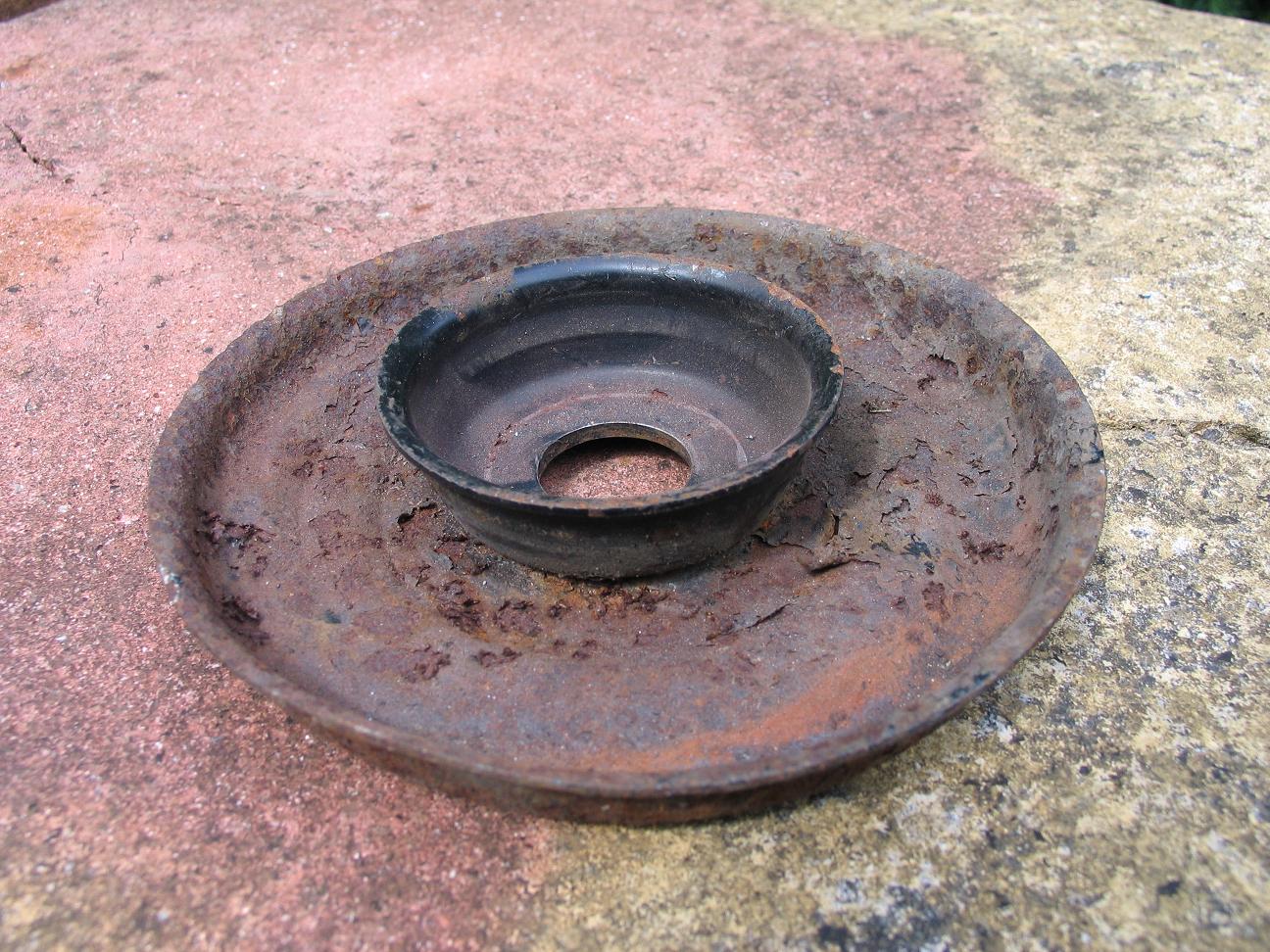

Have discovered another problems - tops of struts, where holes for bolts to go through has cracked in three places....Aggghhhhh
Posts: 2266
Re: Removing front strut- Advice needed
Post by Ride_on »
Yes this is common on 360s they are a bit weak and the newer version is more corrosion proned. The older ones have a dome for the rubber boot and this seems to be better protected. Although looking at it now I'm thinking the older ones are thicker (3mm at the shock mounting point), but I don't have a newer one out to compare. The problem is usually accelerated by heavy duty shocks.
I was able to get parts before, not sure what can be done now, vaguely remember seeing some threads about it.
300 Strut top cup - pre83 approx.

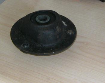

I think he means this one
Volvo 340 L 1983

Ride on, thanks, the pictures are where the problems were..
