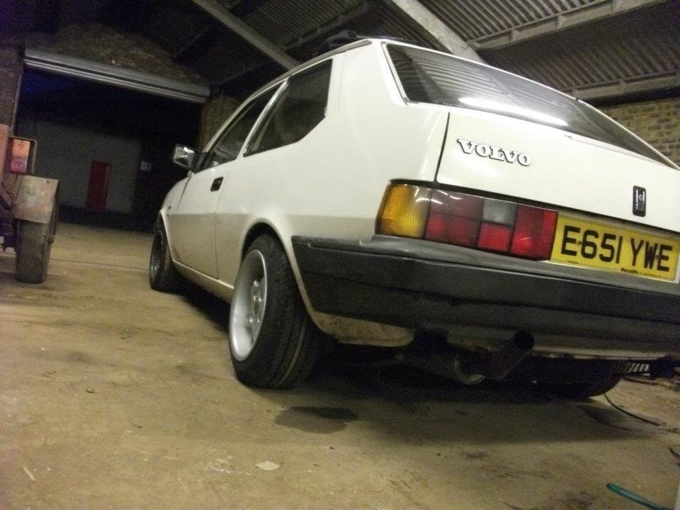

Silver wheels are blocks b5 14x8 et 24 ...I have them for sale right now mate if you fancied. £150

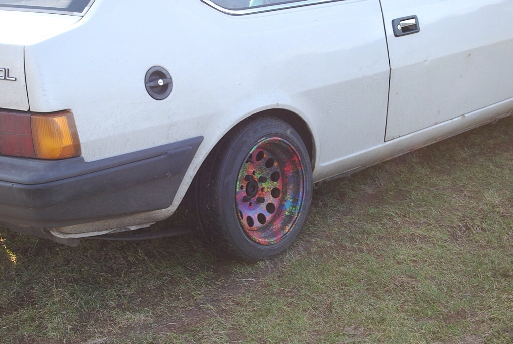

The multi coloured are weller wheels 13x7 et0 I think. Equally cool just ever enjoyed the arch gap they gave

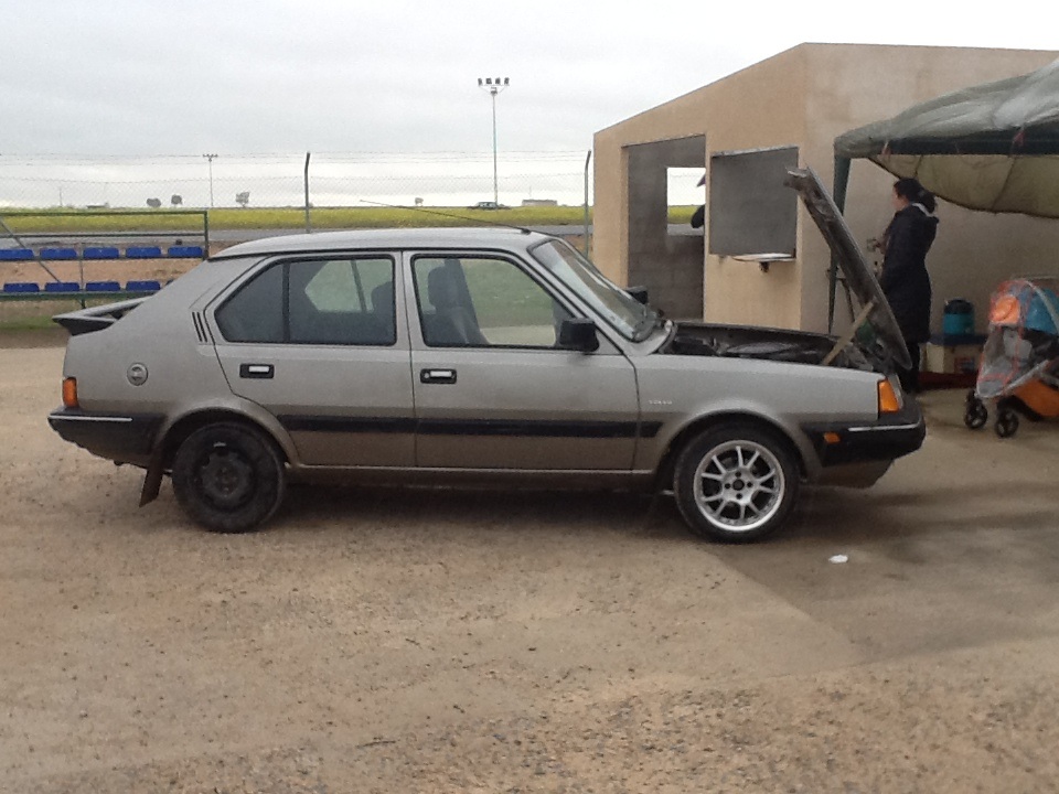

Here it is on 14" alloys of correct offset tyres were 185/60/14 or possibly 195 not sure on that photo
The 15's were again off a 440 and of correct offset. The area directly above teh tyre around the strut opening does need flatening off to prevent rubbing.
Suspension travel was only 25-30mm form normal position to fully compressed with the bump stops removed.
I had been thinking about doing a lot of cutting and fabrication to get it lower but ground clearance would have become a major issue with the roads around here.

Olliehood, wich rims are the rare painted?? They are beautifull and i need somethig like this in spain, because the ITV(tuv) are a f#^}#\@, and with13's i look like good boy jijiji
