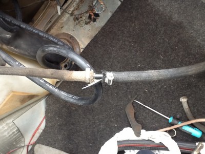

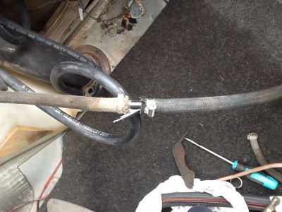

Posted: 26 May 2013 02:32 pm
by Busicrx
Old hose
Old hose
Re: Fuel leak
Posted: 26 May 2013 02:36 pm
by Busicrx
I dont put the t piece of the old hose, and take the hose from the bottom of the small tank upper posible, to if in the tank apears fuel it dont leaks, and i can see if the sistem works

by Ride_on
BTW when I sya they won't last 20 years, I generally mean the ones in the engine bay. the ones at the filler neck do seem to last longer.
Re: Fuel leak
Posted: 27 May 2013 01:07 am
by Busicrx
The hoses of the engine bay seems been changed, not 20years.. The longer hose its because im still thinking if the t piece is necesary , im cornering high to see if leaks in some place to determinate this.
