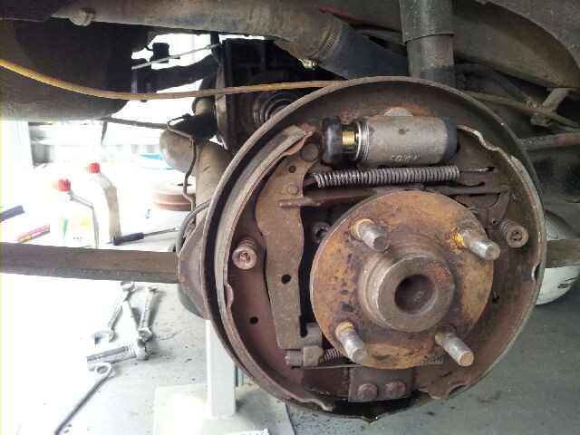

Hi all, tried to bleed my system and managed to do this
brake 2.jpg (94.67 KiB) Viewed 36854 times
I kept pumping the break pedal and could not get rid of the air...hence cylinder popped.

Because you didn't have the shoes roughly adjusted and the drum on at the time...
or because you didn't wire the cylinder pistons down to stop them popping...

If you don't want to put the drum on when bleeding then you find some garden wire or something that you can wind round the cylinder to hold the piston(s) in.
Just stick the drum back on

The cylinder is stopped from falling apart because the shoes hit the drum. With no drum, there is nothing to stop the shoes moving further and further apart.

You also need to reset the self-adjuster, and wind it back in so you can get the drum back on.

1,You must have the drums on when bleeding breaks.
2,You should do the one furthest from the master cylinder/reservoir first and work your way towards it.
3,Dont remove the front calipers to bleed them.

Brakes sorted....no problems...not used to drum....or negative vibes
