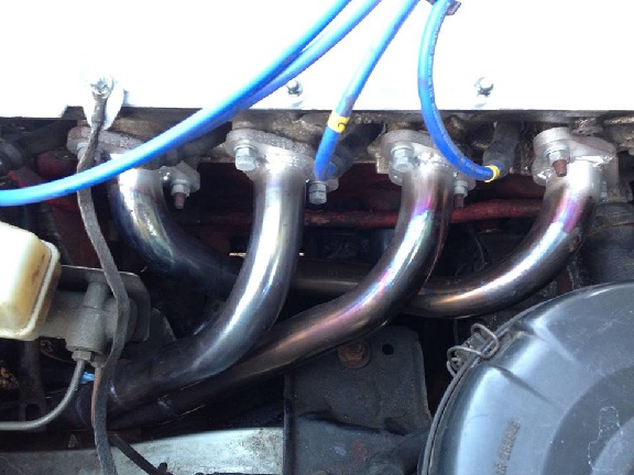

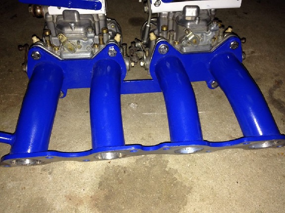

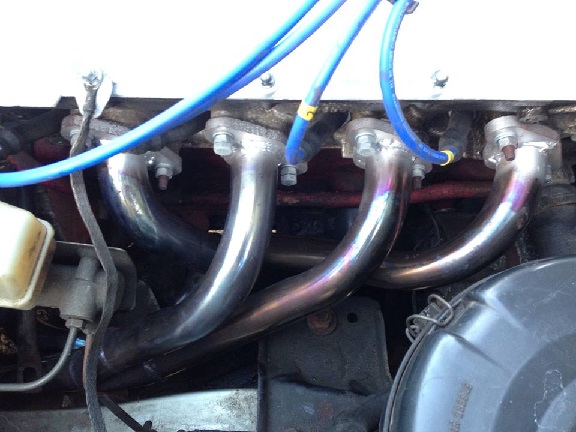

pictures of exhaust manifold and inlet manifold

Posted: 05 Dec 2013 07:42 pm
by classicswede
The manifolds are my ones. Your car is white with power steering iirc
Give me a call and let me know what your goals are power wise.
