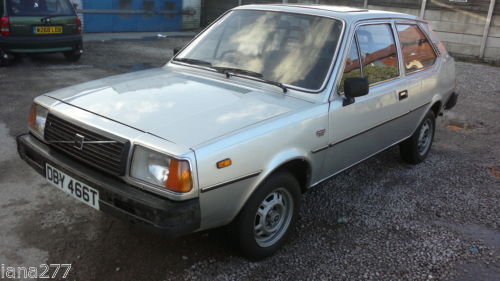

Hi, does anyone know anything about the history of my latest buy, 1979 Volvo 343DL in silver registered 01.05.1979, tidy little car showing just 4800 miles DBY 466T
- Attachments
- 343.JPG (30.56 KiB) Viewed 31745 times
