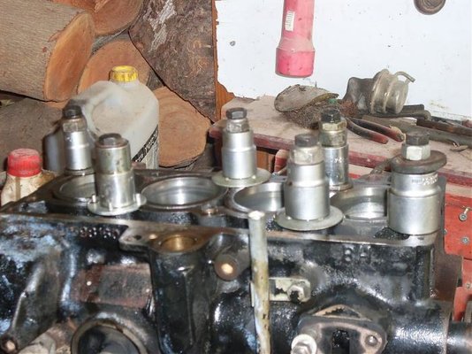

I think I will source some gaskets, and set aside some time to take the head off to see what I can spot. I have never done it before, but it doesn't seem all that complicated (I bet I will regret saying that).
Re: BHX engine unhappy
Just make sure you follow green book procedure when taken the head off and get the correct Volvo Special "don't let the bloody liners move no matter what I do" tool (Some M12 washers from memory, but check!)
Or leave the push rods on Pettaws bonnet when you drive off to get said special tool and have to drive around Rickmansworth collecting them from the corners in the road when they rolled off.

Post by mac »
I have two sets of the "don't let the bloody liners move" tools, (and gaskets in stock for that matter).
The job is well within your ability. - just let me know what you need Siôn.
Mac

Post by macplaxton »
Chris_C wrote:and get the correct Volvo Special "don't let the bloody liners move no matter what I do" tool (Some M12 washers from memory, but check!)
Pah! Just do something with all those odd-sized sockets in the set and use the head bolts.
mac
