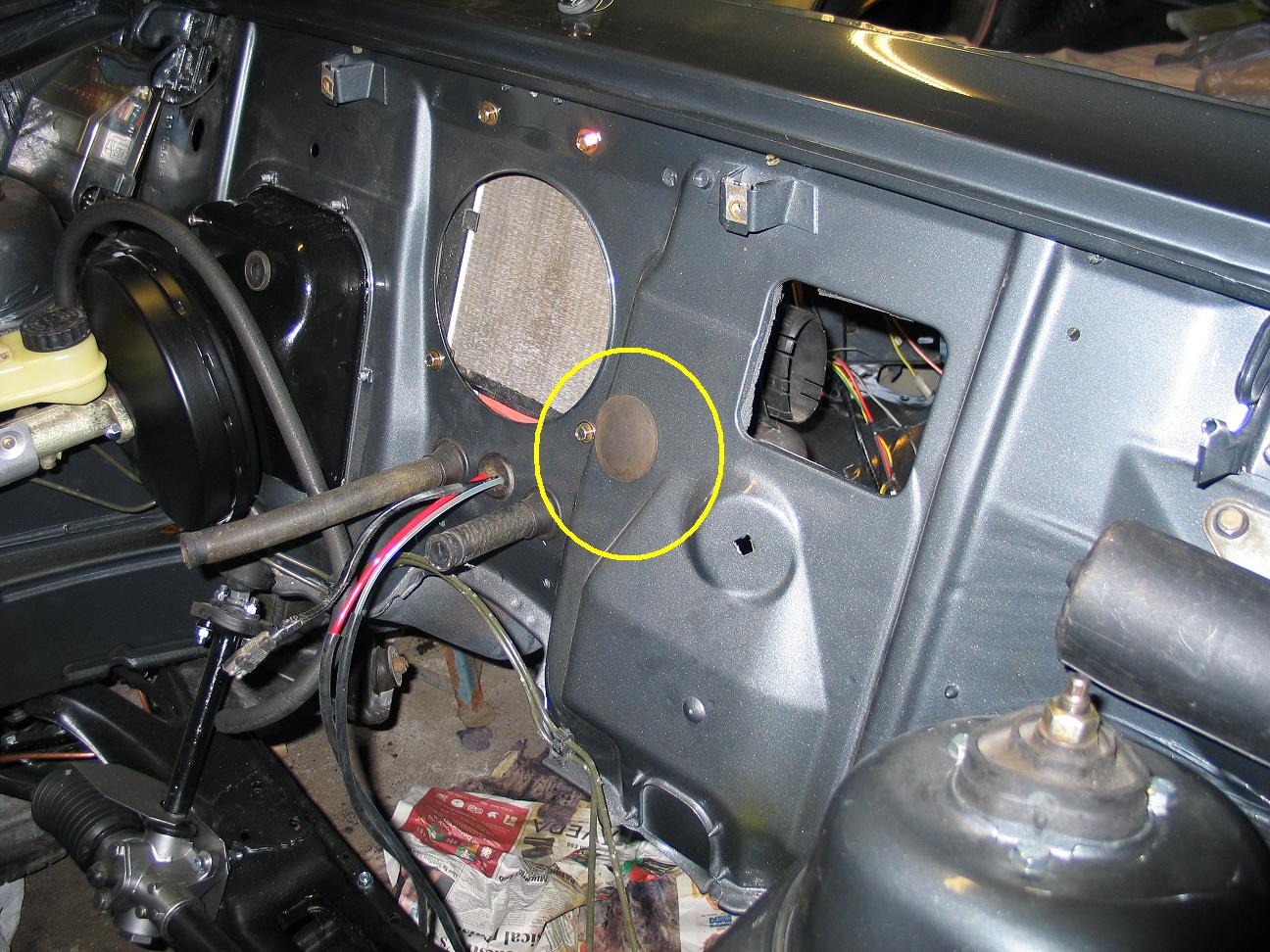

It seems my carb model has a small 30mm unused hole in the bulkheah. From memory this is where the injection loom goes, which needs about 55mm.
Anyone know what size it is and/or provide a photo of the location? I'm going to have to order a hole cutter.

The original injection loom goes through the bulkhead a bit lower near the heaterbox. Oh crap.. you have the steering on the wrong side, so maybe they flipped everything around and it goes through the bulkhead somewhere else?

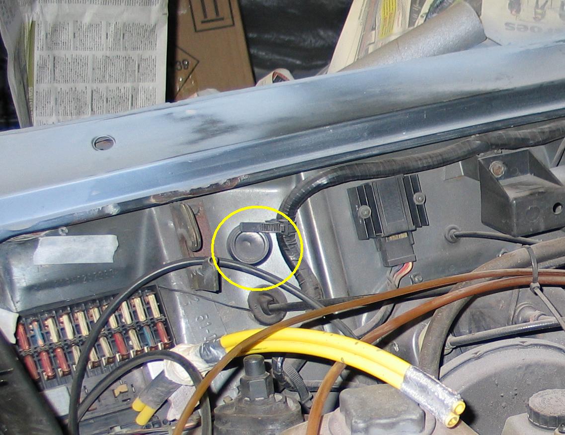

I have just taken a loom out and it does go through under the heater box. On non efi cars a full grommet is in the hole

Ah! is it this;

That should be the one, so they did move the hole in the bulkhead.

it overlaps >50% with the air box although there is a bit of clearance. Hopefully works, saves me cutting holes. Lets see if I can get LH2.4+EZK through it.

LH2.4 harness goes through, you can even use the grommet on the harnessRide_on wrote:it overlaps >50% with the air box although there is a bit of clearance. Hopefully works, saves me cutting holes. Lets see if I can get LH2.4+EZK through it.

I've got a full 940 loom going through there. So it does fit. I had to extend plugs so I lopped the big ones like afm off though.

So I've used the GLT grommet and cut it in the middle. It fits over the connector.
