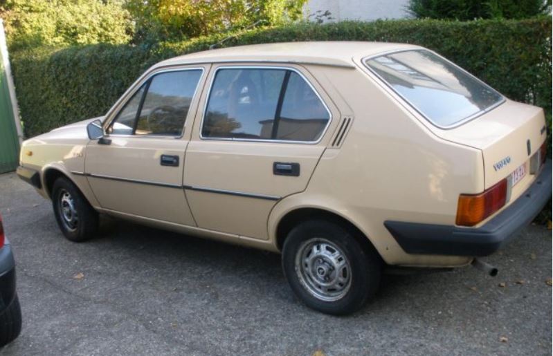

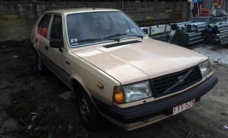

Hello guys,
I hope you're all fine! As I have explained to some of you, the arrival of a little baby changed a lot of things in my life, and unfortunately time left for the Volvo 300 Madness shrank even more... But I do NOT forget you and V3M, I'm just spending more time behind the scene. I'm pretty sure you're still having fun here!
Now having said that, I'm still deeeeply attracted by 300 series and I just can't resist when a nice one is for sale. I just bought a strange one, a very strange one because it's the first time I'm not able to identify properly the car, despite my good knowledge of these cars since years...
The facts: it's a beige 5 doors 300 with a B19A engine and 5 speeds gearbox. The VIN number XLB345213DC****** confirms this, and "DC" tell us it's a '83 model year. The dashboard is the "new" style one, door cards too. Don't look at the tailgate, it has been replaced in the past, badges aren't matching anymore. The body is right (spare wheel at the back, battery space, etc...), it's definitely not a converted B14. There are no tinted Windows and no rev counter!
From my point of view, it's a strange mix between a '82 345 DLS and a '83 360 GLS.
- No foglights spaces -> '82 345 DLS
- No tinted Windows -> '82 345 DLS
- Beige interior with little squares -> '82 345 DLS
- No chrome on the bumpers -> '82 345 DLS
- 5 speeds gearbox -> '83 360 GLS
- New Dashboard / door cards -> '83 360 GLS
- VIN with "DC" letters -> 1983
So it's not a 345 DLS, and it's not a 360 GLS! Which model is it? Can we imagine a "late" 345 DLS production with parts of the future 360 GLS in use? It's weird! I've never seen this before... Help! :mrgreen: Any idea? The color is also quite "basic" for the B19 on the belgian market, but it was quite common to see that kind of combination (non metallic paint + B19/B200) in Scandinavia, another strange point...

macplaxton wrote:Has the tailgate just got "360" on it?
It has "340 DL" on it! The tailgate paint isn't excatly the same, something happened (respray or whole tailgate changed, I don't know yet) But now, reading Tom's post, I'm thinking the "340 DL" is maybe right, and that's crazy! A '83 340 DL with B19A and M47 5 speeds gearbox? The most insane thing I've ever seen on a 300 :D

But if the VIN plate correct, it shows market code "20" for Belgium, not "10" Sweden or "13" Finland. (Plus those markets might have headlamp washers?)

macplaxton wrote:But if the VIN plate correct, it shows market code "20" for Belgium
+1! I forgot that market code. I'm confused again, a belgian car with some scandinavian specs & badging? :D
macplaxton wrote:(Plus those markets might have headlamp washers?)
Good point, but I'm not 100% sure they all had headlamp washers there in 82/83? Engine pre-heating system was also very popular, I couldn't see one...

I know of Dutch (MC21) cars that were sold in 1982 (no MY known) amongst others to the police that were badged as a 340DL but were in reality a DLS. Ussually used over there as a plain clothes car.
Looking at the VIN plate it is indeed a MY83.
I saw the ad in Belgium as well but thought the opposite; that it was a 1.4 and that the owner had advertised it as a 2.0 out of ignorance or in the hope of getting a faster sale.
Fast it was for sure as you got it..... :lol:
I think that the tailgate is the original one, looking at the paint, and that is a "Wolf in sheeps clothes" intentionally.
To be 200% sure you will have to have a look at the tailgate bolts "inside" the ceiling.
For some markets a sticker was stuck at the back to market it as a 340 2.0l
I will have to have a dig in my folders..... :?: but time.

I feel better if you confirm that you wouldn't have expected a version like that in Belgium :D , The 343/345 DLS has the old dashboard style and M45, don't you find surprising that this one has the new dashboard style and M47 gearbox?
volvomania wrote:I saw the ad in Belgium as well but thought the opposite; that it was a 1.4 and that the owner had advertised it as a 2.0 out of ignorance or in the hope of getting a faster sale.
To be honnest, I thought the guy simply mixed by ignorance registration year and cylinder capacity... :D But there was still a doubt because I couldn't see the prominent B14 fuel tank on the pictures (I know, a real Sherlock Holmes investigation with sophisticated brightness and luminosity analysis of the existing pictures... I'm not normal haha :D ) Because of this only remaining doubt, I decided to go there in the evening with a flashlight, I was pretty sure to find a B14 and to leave the place immediately. First check: oh oh, no B14 fuel tank at the rear! Second check: oh oh, the bottom of a B19 engine! Very exciting moment, it wasn't a quick stop anymore :lol:
volvomania wrote:I think that the tailgate is the original one, looking at the paint, and that is a "Wolf in sheepd clothes" intentionally. To be 200% sure you will have to have a look at the tailgate bolts "inside" the ceiling.
I'm pretty sure something happened with the tailgate; it's not closing nicely when it falls down, there is definitely a small color difference with the rest of the car, the Volvo badge is too much to the right, and there are small ceiling damages where the tailagte bolts are located... A closer and deeper investigation is needed!
volvomania wrote:a "Wolf in sheepd clothes"

Odd that both your car and the red Swedish one look to have the Volvo badge on the tailgate at the incorrect height too? The same incorrect height? Or was it supposed to be that low at that time?

Chris_C wrote:Or was it supposed to be that low at that time?
Supposed to be that low, I think the question was how far in from the left it was.

That is a strange combination! The boot badges are supposed to be that low - but strangely on Aymat's beige car it looks as though the 'Volvo' badge on the bootlid is too close to the centre and it's also silver, I'd expect a car of this age and being a DL to have black badging - this seemed to coincide with the all black bumpers and black grilles on earlier DL's. EDIT: Should've read your post in more detail, you know this :D :lol:
What's the paint match like on the front valance? Could it perhaps have been in a front/rear bump - with the valance skin being replaced with a 340 one? Sounds like a long shot....! Do you have some form of logbook with it to see what it was originally registered as? Regardless, it's a strange colour for a B19 car!
I can't remember ever seeing a 2.0 car fitted without the cut outs in the front valance come to think of it!
