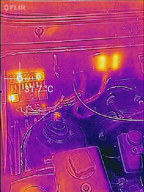

Well just to play with my new toy I captured a thermal image of the fuse box, lighting pos 1 and ignition on.
The noisey fuse does indeed get hot (40C) as does the dim dip relay however the yellow wire or connection did not, So I think that eliminates it from enquiries.
Thermal image of dim dip mode
dim dip engine.jpg (445.65 KiB) Viewed 83117 times
Also checked the dip dip relay (it says relay on it but it doesn't click) disconnected, all you lose is the dim dip mode, which I don't think is really needed.
The melted plastic could have allowed a short inside the fuse box.

That picture is amazing to see! Thanks! This group is the best! :D I'm really hoping the problem lies inside the fusebox, and I'm fitting it today, so we will see what happens!

Wicked photography, but what else are you planning to do with your thermal imager ;-?
