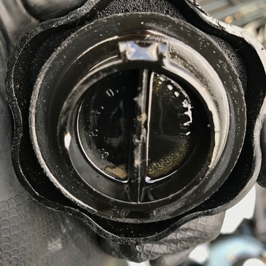

2.No evidence of head gasket sludge, just some light misting on the filler cap that's probably because it's spent most of the last 6 months standing:
Oil filler cap
Oil filler cap

UPDATE: Added just under 1L of oil. The fan comes on just as the temp gauge tips past the middle and that brings it back down to pretty much dead on center. I'll do a full oil change at the weekend (Castrol Magnatec 10w40 A3/B4) as I reckon the oil inside is dead and useless. Thinking about it now it's probably not been changed for nearly 15k miles since the last service stamp 4 years ago and has been off the road for much of the 3 years before I got it.
