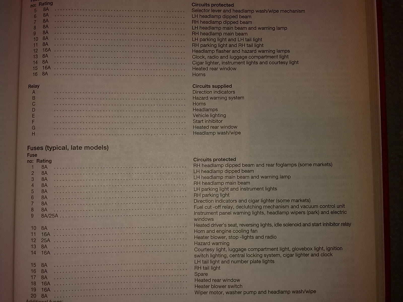

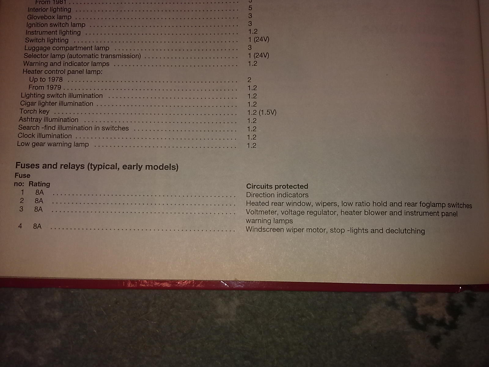

Does anybody know what fuse is for what in the fusebox for a '86 1.6DL? Mine is the old type which doesn't use spade fuses, and unfortunately the casing isn't marked, and the Haynes manual is completely useless as regards this fusebox.

Unfortunately I don't have the original owners manual, I have a Haynes manual, but unfortunately it's completely wrong for my fusebox.
