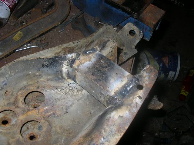

To start you will need the crossmember removed
The main area of problems is where the wishbone bolts on
You will need to bolt on the wishbone to hold things in the correct position while welding
You now need to clean up the area below and cut a peice of 40x40 angle
This will help to stop twisting in the area
This is where the special tools come in a welder a mig is best but as it was near by I used the arc. Fist off tack
And then make sure the wishbone is free to move and does not get obstucted by the angle
You can then fully weld
And then do the other side

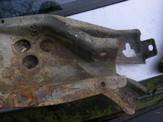

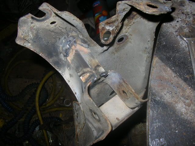

Ok that is step 1 completed now for part 2
Look at the pic below. This area needs reenforcing to prevent the bottom part of the x-member pushing up
A bit of 1" (25mm) angle should do the trick
The final part that is not done yet is to sand blast and paint.
