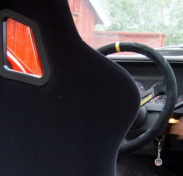

I bought a new Luisi boss for my 360, it was like 38£ in Norway.
And with a "not so cheap" Sabelt Wheel, you get this:

It's just the look I want... Beautyful as usual NikDev !! :wink:
