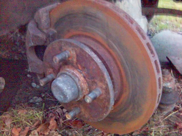

Here is my capri 2.8 vents on my 300,they work quite well but i'm always looking to upgrade my upgrades.
http://i170.photobucket.com/albums/u265 ... 8vents.jpg
http://i170.photobucket.com/albums/u265 ... vented.jpg

Interesting! Were those a direct fit, what modifications were needed? And what calipers are you using? :P

Almost a direct fit.I redrilled holes to suit the hub or you can oval the existing holes and took a small amount off of the caliper fingers and the carrier to accept the thicker disc.

I used to work in a privately owned Volvo garage in the welsh hills and have done this upgrade on numerous 300's from all over Wales and England,so yes I might have done them but I can't say 100%.
