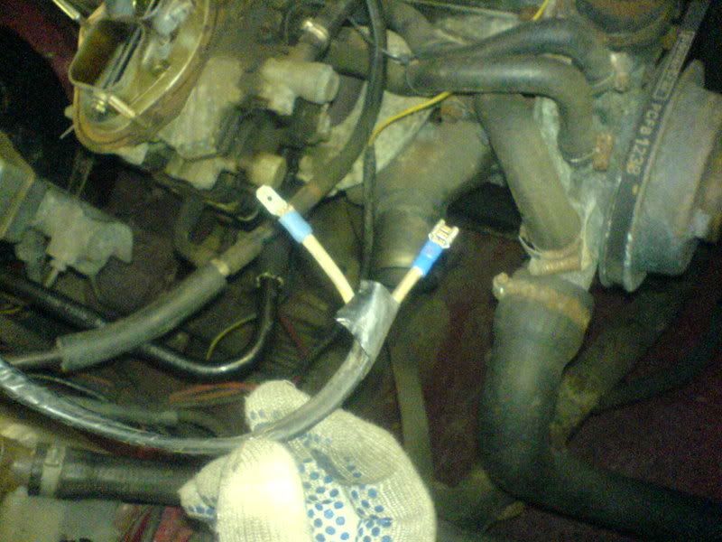

Been recommisioning the vario, and adding the 6 gauge dash unit. I've come unstuck trying to wire in the temp gauge. Here's the blue leaflet picture:

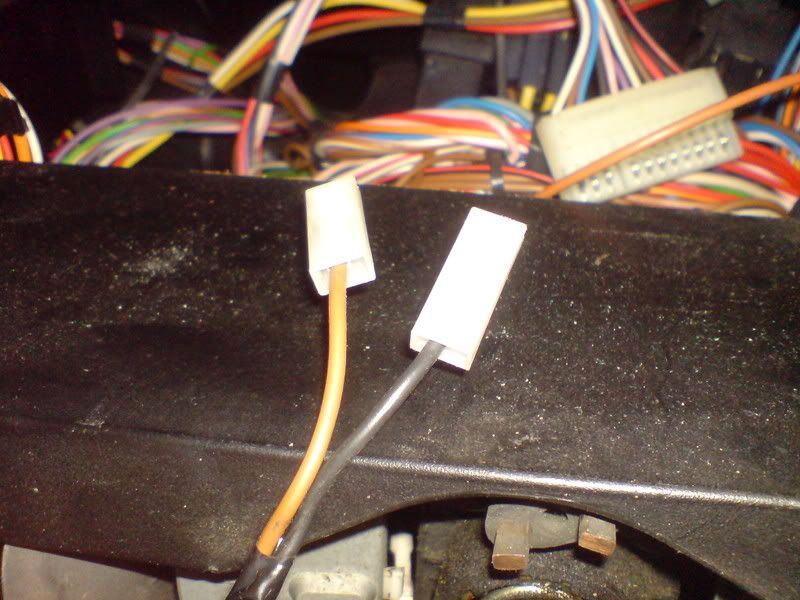

The cable ends are different though:

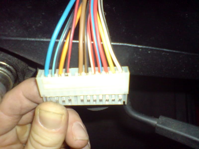

I can pull a couple of connectors from a spare multiplug:
Looking at panel 11, I'm missing a length of cable, so it'll be bodgery then.

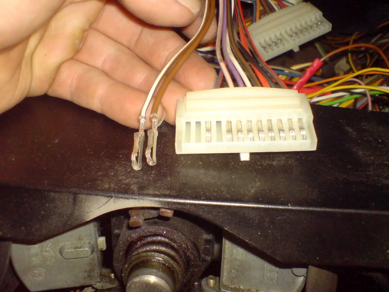

It says to fit them to slots 6 and 12, but they're occupied already:
What shall I do, splice them in or what?

Which bit you having issues with mate? Under the dash (normally taped up) will be an earth and a black/white stripey (I think thats what you are showing in your "ends are different piccy) Just male spade into them (they are female spades) straight to the sender

This is a job I've been meaning to do for years... Some cars have the wiring already in place (mine doesn't). If those slots are already full then it suggests yours does. Root around the front of your car for spare ends near your offside headlamp.
http://www.filterfeeder.eu
All the 340s I've done Ronnie (all post 88) have had the wiring up to the steering column (i.e. it's in the dashboard connectors, but ends in 2 female spades taped up under the dash) It's only GLT's I've seen the wire run all the way to the front on.
Posts: 7944
Yeah the GLT's usually have the wires somewhere near the front or under the airbox somewhere tied up
Post by filthyjohn »
Aha, Cheers for that, I'll have a rummage around for them then. I've already fitted the sender behind the bumper and run the wires into the cabin, so I'll have a darn good search tomorrow and report back.
