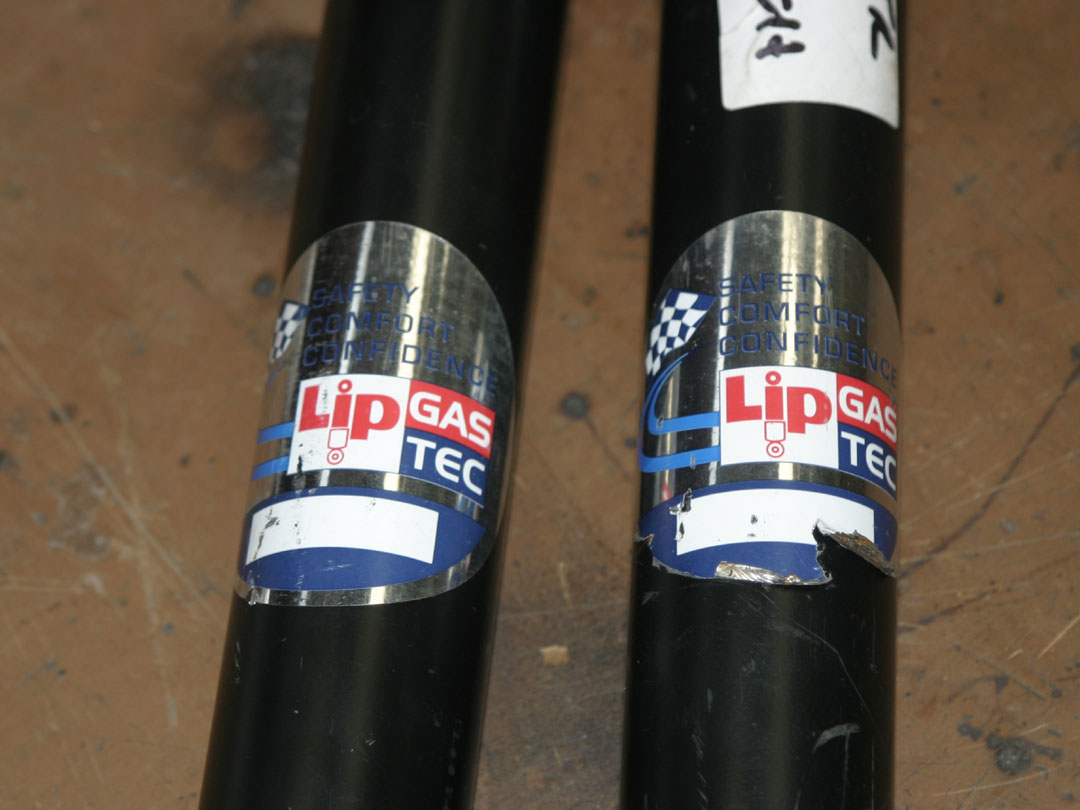

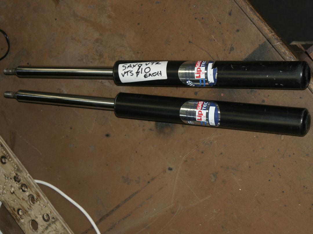

Just wondered how useless these things would be for a 340? They are nice and stiff!
The total length is 585mm and the diameter is 45mm. Can anyone tell me if they'll fit the Volvo, given these dimensions.
Cost me £20, and never been used.

Jos360
Posts: 181
Joined: 14 Jun 2008 10:31 pm
Re: Saxo VTS shocks???
Post by Jos360 »
They should fit i think. The length of a 300-series shock is 600mm extended and 465mm when fully pressed-in. Diameter is 44mm. Check some pictures and measurements i took on:

Post by filthyjohn »
Those won't fit the volvo strut tops BTW. I think you'd need to make some adjustable top mounts from escort ones, or get the damper rod machined to go through the volvo top.
Posts: 5471
Post by classicswede »
By the look of it the bottom will be too fat to fit as the 300 series one has a step in it to fit.
^^^ You mean the slightly narrower bottom 15-20mm? Noted, I have some ready to be fitted to VND's 360 I could accurately measure if that'd help anyone.
