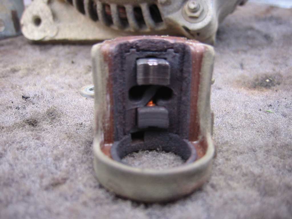

I have repaired the alternator in three different cars:
Seat Toledo -98 1.9D at about 250000 km (Bosch)
Seat Toledo -96 1.9D at about 315000 km (Bosch)
Volvo S40 -98 1.9TD at about 325000 km (Valeo)
Haven't had to touch my 340 or 360 alternators yet.
In all cases they didn't work due to worn out brushes. When I repaired the first one, I just didn't know enough and bought the whole regulator, that comes with new brushes installed. For the second and third ones I found new brushes and replaced just those. It wasn't an easy job though, mostly because the regulator is usually built so that it is easy to mass produce and some parts are protected from corrosion with some elastic resin (maybe silicone?) that is sometimes a bit hard to scrape off. But since they're basically just a piece of graphite carbon with a wire attached, the whole thing cost maybe one euro to replace.
Anyway the local Motonet sells the regulator+brush assembly for B172 "Paris Rhone" alternator for 13.50 euros. That should be easy enough to change, instead of swapping the whole alternator.
And here's a picture of some random (very worn out) brushies :
