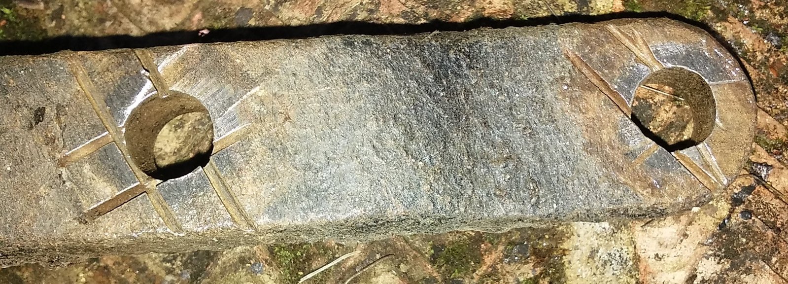

Hello, I need some advice because I am trying to change the bushes on the above said rod and on removal I found the following:
The strut was replaced with a repaired one by the previous owner's mechanic and they have obviously used a cutting disc to square-off the bolt-heads for ease of removal. Funny cos a flipping 53 year old with backache managed to do the other side non-destructively with only molegrips and spanners, duh. The cuts are about 2 - 3 mm deep from eyeballing them. Could a welder fill in the cuts or is it not necessary? Bit perplexed.

Re: Radius arm to chassis rod
I personally would get them filled in for piece of mind and those cuts will make a weak point so a big pot hole could cause damage.
Either replace them or get them welded up.
But leaving them as is is a big nono for me as the cut weaken the entire rod.
Cool, thanks both.
Gosh - sorry. I took it to the welder just now. He'll do it for a beer ;-§

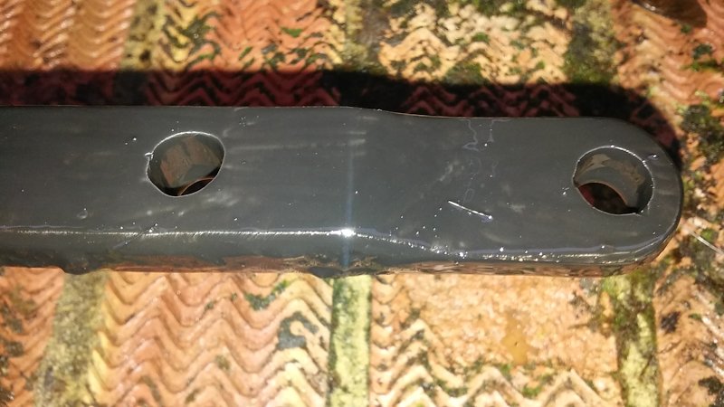

Cool, repaired....
Looks much better now
