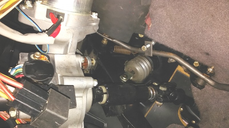

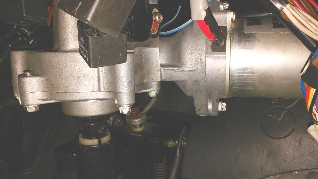

... and here are some views of the underside of the steering column...
... hope this helps. I took the car through a couple of three-point turns in the garage yard and it does work well with the rheostat set about half-way or more.

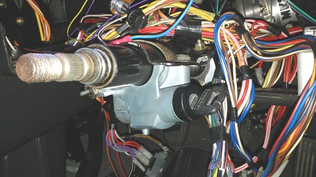

Its all a bit more apart now with the ignition switch and column bracket removed.
For replacing the relays, here are some notes.

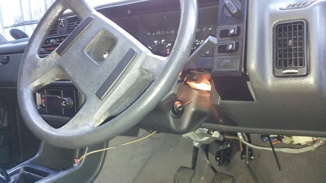

Hello again, long gap in comms. Here is the latest set of photos showing the new EPS being fitted to the beautiful deep blue 1.7...
... so far so good.
... so far so good.

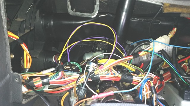

Hello again folks, a bit more progress on the power steering for the deep blue beastie.
It is all wired in and seems to work well when tested, so it shouldn't be long now.
N.B. I think I had the black and white wires the wrong way round at this point which causes the power steering not to work. I also remember that one of them had to be connected elsewhere in the end to make sure that the PS only came on when the ignition was switched on, otherwise it stays on all the time and presumably drains the battery or knackers itself in no time at all. So whilst the black and white wires look wonderful slotting into that connection block, it is actually incorrect to wire it this way, sorry!!
