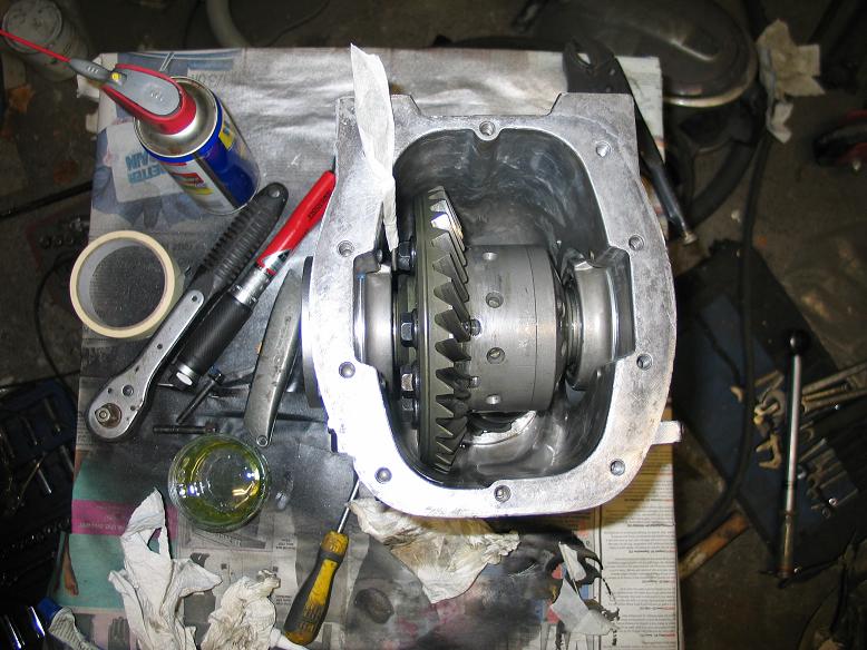

Well got the bits and got the main reassembly done.
Bearings dropped onto the crownwheel and new LSD with a bit of heat (180C), and the outer race the same into the aluminium bearing retainers. (outer parts heated, inner parts cooled if possible)

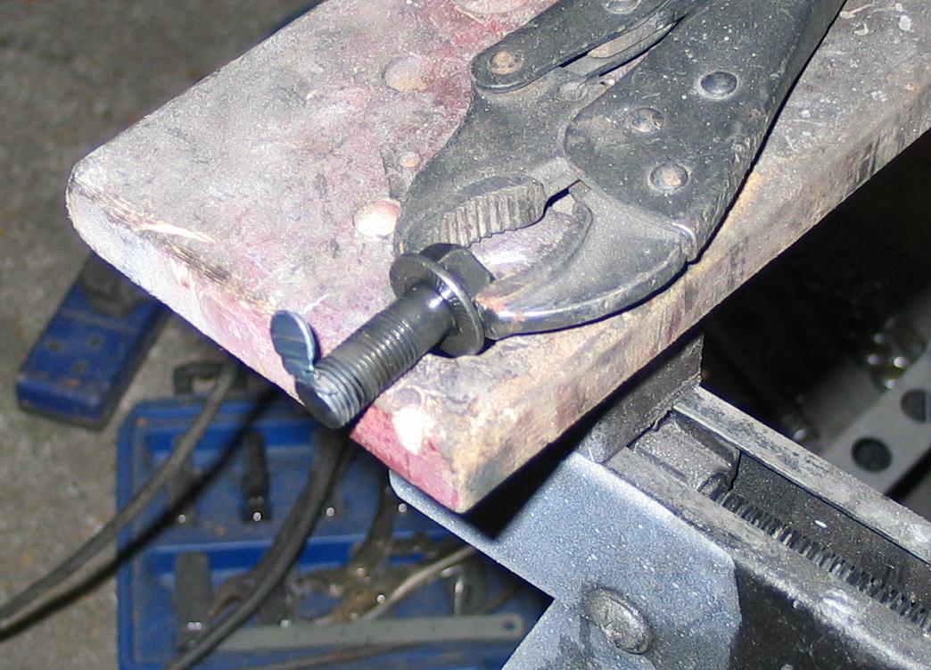

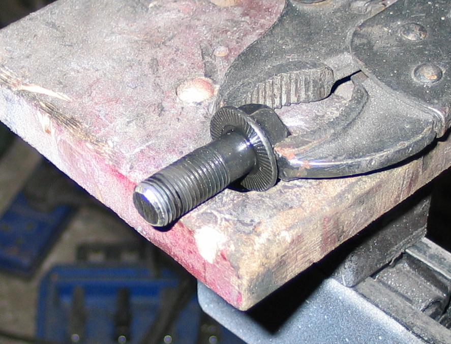

The crownwheel bolts had to be cut down to 30mm and a couple of long 10mm bolts (spare from rear springs) used to hold the crownwheel as the new diff is round. The original diff core has flat parts I could grip with the workmate but no grip method would work on the new diff. After checking with a drill bit, I think socket head bolts would fit as there is nearly 4mm and these would only add 2mm. Hard to check the rear but the main close part is the oil catcher for the top of the bearing. A standard socket cap bolt would not have the same flange or serration but it works fine for many other locations and does have the same contact area as a hex head (just not a flanged hex head).
The new assembly seemed a good level of 'stiff' and could be turned by hand at the wheel drive flanges(but not in opposite directions unlike the open diff), so I figure the pre-load is ok. I added a bit of instant gasket to the spacer both sides on the outer diameter to seal it up and keep moisture away from the steel-aluminium interface.
Holding bolt for cutting
Initial cut with big grinder
trimmed and bavelled with small grinder
about 1 thread left in this hole before bottoming out
Tightening the bolts to 90ftlbs using the spare unthreaded holes
Enough space for 12mm socket bolts
