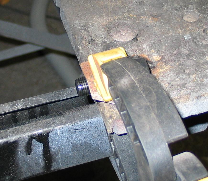

Holding bolt for cutting

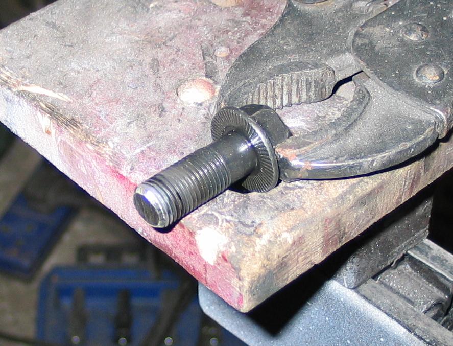

Initial cut with big grinder

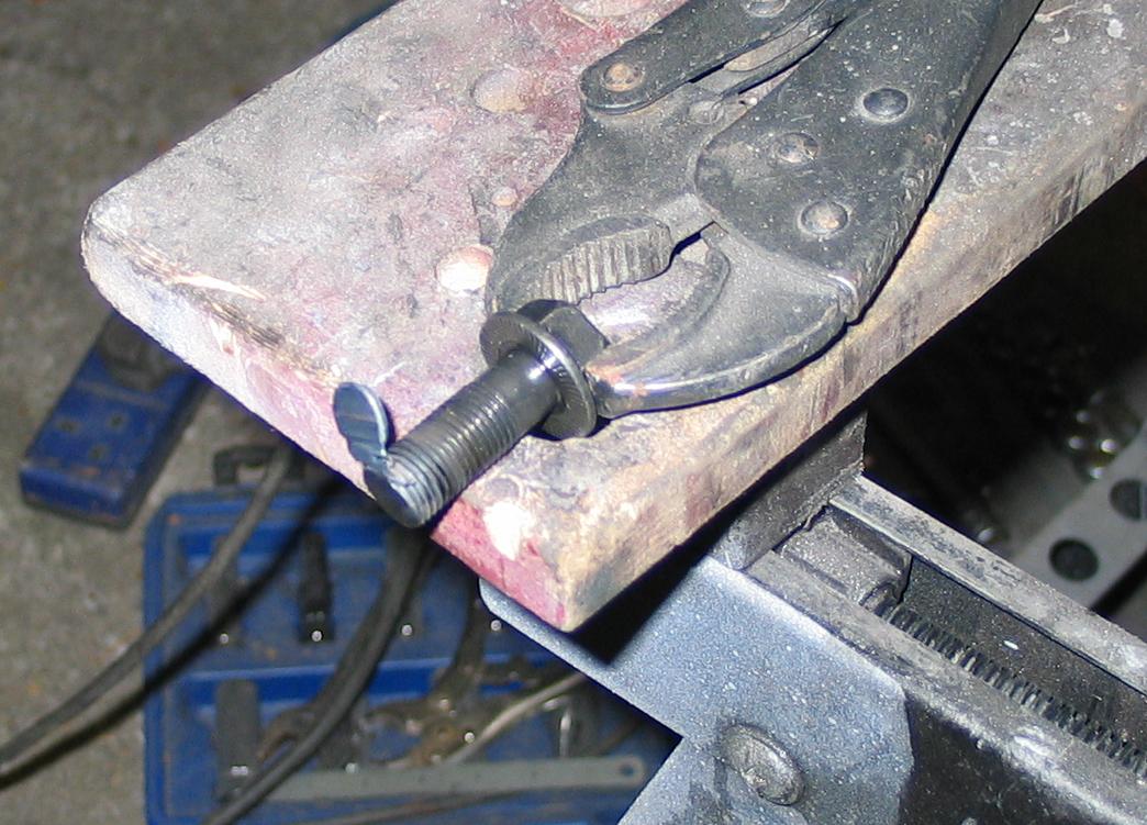

trimmed and bavelled with small grinder
