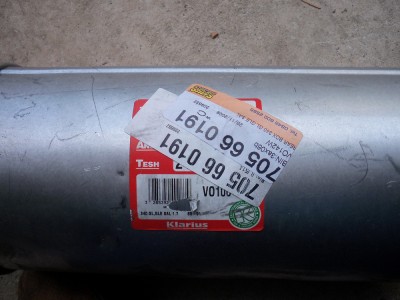

I bought a back box for my 1.4 from Eurocarparts, despite using supplying a number plate the exhaust that came was wrong. It is roughly the right shape but isn't an exact match for the 1.4 back box. Most notably the pipe is of a considerably larger diameter.
Did the 1.4 and 1.7 340s have different back boxes?
The stickers on it say "VO 142W 340 GL GLE SAL" and "340 GL, GLE SAL 1.7 85-91".
Also did the saloons have different back boxes to the hatchbacks?
Any help in identifying it would be greatly appreciated.
I forgot about it and it is now too late to return it to Eurocarparts so I'm open to offers regardless of what it is!
Possibly a 1.7 back box?

I'd go by the bottom-most label and say it's a 1.7 back box. Looks like it's been mis-labelled along the way. Bosal site has different part numbers for the rear silencer on a 1.4 / 1.7. (No difference between saloon or hatchback.)

Alex, I've looked up the Klarius online catalogue (must admit, never heard of them before) and it's two different part numbers.
1.4 is VO71G
1.7 is VO142W
