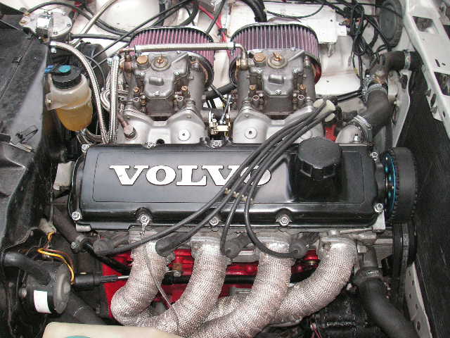

Sounds and looks like it goes great, what's the engine spec of white car?

Re: Peter Schmidt's newest build
Engine
B230 block
Marin crankshaft 86mm strok = 2500cc
H-rods
Ported 531 cylhead with bigger valvs 46-38mm
camshaft 316 dur 13,2 lift 106 nock
Dubbelsprings
Home made exaust sytem
Twin weber 50 dco
aprox 240 hp

I spot adjustable cam gear, relocated master cylinder reservoir and power steering?
Have you been on dyno with that setup yet, what kind of torque curve it has?
Last year it make 229 hp and 308nm with 48mm carbs and 2½ exaust, now with 50is and 3" exaust approx 240hp and 320-330nm .
Great figures and torque for N/A
wish i could get away with that on a road rallypeter schmidt wrote:Engine
B230 block
H-rods
Dubbelsprings
Twin weber 50 dco
aprox 240 hp
