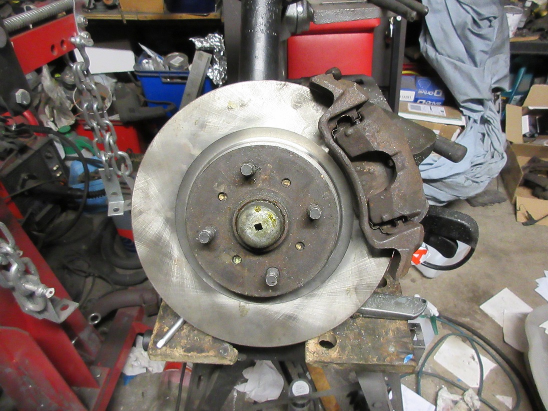

So after lots of research and test buys I'm now on a solution for 15" wheels at the moment. This is easier
Disk: Merc W168 A190 (276mm)
Caliper: Merc W168 A160/170 caliper and carrier (for smaller disk)
They use the same pads so the radius difference is ok for Mercedes.
The disk gives a similar offset to the original, allowing space for the disk guard and space to the rubbers on the ball joints. Also more importantly enough space for a chunky adaptor without much trimming of the Volvo or Merc parts. The 360 brake bolts will fit from the opposite side (with a small trim of the Mcer Carrier)

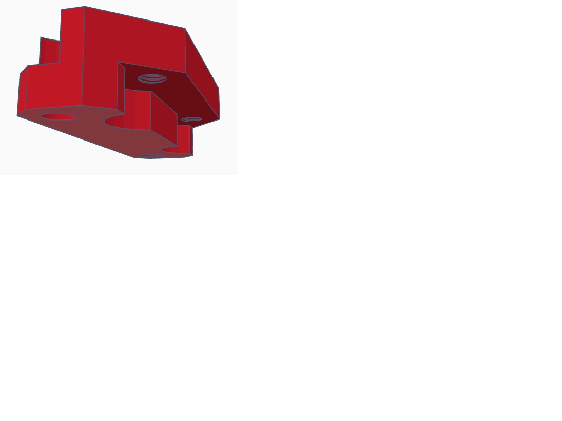

Adaptor being printed in plastic at the moment.

Proto still isn't printed, and past predicted date :(

Well adaptor prototype in PLA fitted after a little extra material removal and retapping my incorrectly designed threads.
Everything fits nice in 15" wheels but not 14". A set of 4 pots fix caliper would be better. Also a little worried about thin section of the merc disk where the bolts go through. its very close to the edge of the hole and the Merc disk is 1 or 2mm thinner I think. A custom disk could be done if necessary.
